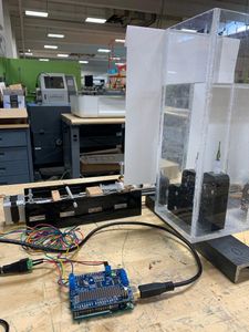

Step 1: Making the Acrylic Tank
1-1: Using the tutorial as a guide, build or procure an acrylic tank with your needed dimensions (we received one from our research partner). (https://www.wikihow.com/Build-an-Acrylic-Aquarium).
1-2: Before assembly, one of the side panels, drill a 7/8" diameter sized hole, so that after assembly it will look like the photo above, and fit the Size #4 rubber stopper.
1-3: In addition, on the Size #4 rubber stopper, drill a 3/32" sized hole so that the PVC tubing can fit inside it.
Step 2: Syringe Pump Assembly
2-1: Following the below tutorial, build a Syringe Pump assembly.
https://www.instructables.com/DIY-Syringe-Pump/
Note for Step 5, "Wiring the Stepper Motor", you are using an Adafruit Motor Shield; instructions on how to assemble & wire it up is in the tutorial below.
https://learn.adafruit.com/adafruit-motor-shield-v2-for-arduino/using-stepper-motors
2-2: Unscrew the tall, vertically-pointing screws at the opposite end of the motor, remove the acrylic, and place the syringe so that the cylindrical portion rests on the bottom piece of acrylic. Place a piece of cloth on top of the syringe to avoid friction. Finally, replace the top acrylic piece and screw tightly to ensure a tight seal.

Step 4: Final Assembly
4-1: Slide the #4 rubber stopper with the predrilled hole into the horizontal portion of the tubing. Make sure to have the side with the larger radius facing the nozzle holder, as it will be used to plug the side hole in the tank.
4-2: As seen above, place the nozzle holder inside the tank. Route the tubing out of the tank by the predrilled 7/8" hole in the acrylic tank, and then plug that hole using the rubber stopper.
4-3: Cut the extra length of the tubing so that the tubing ends around 10cm away from the side of the acrylic tank. Connect a plug tube luer lock coupling to the end of the tubing. Use glue gun for a better seal if you would like.
4-4: Connect the three-way valve to the plug luer lock on the tubing.
4-5: Connect the syringe on the syringe pump to the three-way valve.
4-6: Attach a sheet of diffusive paper to the back of the tank using tape, and add bright LED lighting pointing towards the back to better illuminate the surface. This will improve the quality of our image analysis later on.

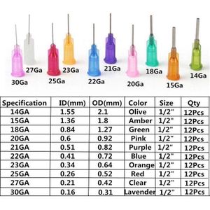

- Refer to the chart above of the nozzles used in the design to select an appropriate nozzle size. The list of available nozzles and their ID and OD information could be found above.
- Screw the nozzle tightly onto the Luer lock to ensure that there is no leakage.

One key benefit of our design and the multiple anti-leakage devices it employs is that you can change the nozzle without removing the water (as long as you don't mind getting a bit wet!) If you want a new bubble size, you just need to choose a new nozzle, which theoretically determines the bubble size using the equation discussed in Background.
- Reach your hand into the tank and very carefully unscrew the nozzle from the Luer lock, and remove it from the tank.
- Choose a nozzle that yields your desired bubble size and make sure that it is free of debris and clear and does not have any problems like being bent, etc.
- Reach your hand back into the tank and screw in the new nozzle. Push at least 100 steps using the Arduino serial monitor to get bubbles flowing.
That's it! It's as simple as that to change the bubble size.

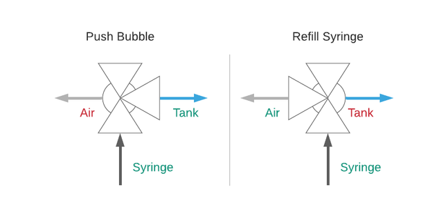

- When there is little air remaining in the syringe, switch the three way-valve to connect the environment and the syringe as shown in the figure above in the "Refill Syringe" mode.
- Enter "-800" in the Serial Monitor in order to pull back the syringe and fill it with air. Repeat with smaller increments as needed to fully fill the syringe with air.
- When the syringe is full, switch back to the Push Bubble mode in the diagram above, and resume generating bubbles using the instructions in Generate Bubble above.
