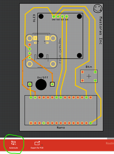

Step 2: PCB Design With Fritzing
Now that our breadboard prototype is working smoothly, it's time to take the next big step – designing a custom PCB for your game console. Fritzing is a fantastic tool to assist in this process. Here's how to do it:
  1. Open Fritzing: Launch Fritzing and create a new project for your game console.
  2. Create Your Schematics: Begin by creating the schematics. This provides a solid foundation for your PCB design.

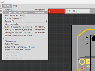

  3. Auto-Route and Refine: Use the auto-route feature to establish initial connections. Then, manually adjust and fine-tune the wiring for both functionality and aesthetics. Ensure that no wires overlap, and connections are neat.
  4. Design Rules Check (DRC): Run the Design Rules Check to validate your design. This will help identify and rectify any potential issues.
  5. Component Placement: Arrange the components on the PCB layout as you see fit. Make sure they fit comfortably, and the dimensions align with your project's requirements. Don't forget to include a hole for the on/off button.
  6. Customization: Add text labels for each component and any pins that might be confusing. This step is critical for clarity and ease of assembly.
  7. Personalize Your Design: Make the console uniquely yours by adding your name or any artwork you desire.
  8. Iterate and Customize: Feel free to use my design as a starting point and make adjustments to suit your preferences and project vision.
With your PCB design ready, you're one step closer to bringing your single-button game console to life. This customized PCB ensures a professional look while maintaining the integrity of your initial concept.

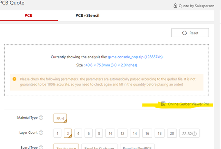

Now that your PCB design is perfected, it's time to turn it into a physical reality. Follow these steps to order your custom PCB from NextPCB:
  1. Export Gerber Files: In Fritzing, export the Gerber files for your PCB design. These files contain the information needed for manufacturing your PCB.
  2. Create a Zip Folder: Compress the Gerber files into a single zip folder to make it easier for uploading and sharing.
  3. Visit NextPCB Website: Head over to the NextPCB website to get started: NextPCB
  4. Upload Your Design: Use the website's interface to upload your zipped Gerber files. Be sure to double-check the parameters that are automatically parsed from the Gerber file. Although they are generated automatically, it's crucial to review them for accuracy.
  5. Quantity and Solder Mask Color: Fill in the desired quantity for your PCB. The default solder mask color is green, but you have the option to change it to any color you prefer (note that the cost may vary depending on your choice).
  6. Online Gerber Viewer Pro: As a final check, utilize the very cool Online Gerber Viewer Pro on the website. It's a free tool that can provide a report with "pass," "warn," and "risk" items. Ensure that your design meets the necessary manufacturing standards.
  7. Proceed to Checkout: Once you're satisfied with the design, parameters, and the Online Gerber Viewer report, proceed to the checkout to place your order.
  8. Wait for Delivery: After placing your order, patiently wait for your custom PCBs to arrive.

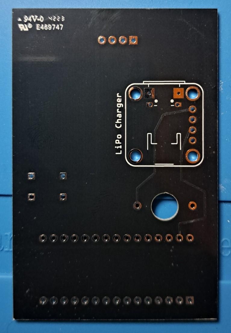

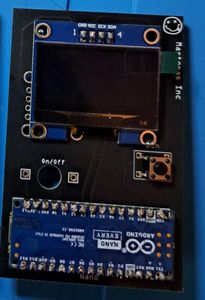

Step 4: PCB Assembly and Testing
With your custom PCB in hand, it's time to assemble your single-button game console. Follow these steps to bring your project to life:
  1. Gather Your Components: Collect all the components you've prepared, including the custom PCB, Arduino Nano, OLED display, micro LiPo charger module, push button, on/off switch, and 3.7V lithium battery. Ensure you have your soldering iron and solder ready as well.
  2. Component Placement: Carefully place and solder each component onto the PCB one by one. Start with the low-profile components and work your way up to the larger ones. Pay close attention to polarity and pin placement for each component.
  3. Battery Placement: Leave the battery at the very end. You can use creative methods like double-sided tape or Velcro to secure the battery to the back of the PCB. Make sure it's positioned securely but is also easy to access for replacing.
  4. Final Connections: Once all components are soldered in place, double-check your connections. Ensure there are no loose solder joints, bridges, or shorts.
  5. Power It Up: Carefully plug the battery into the connector, and switch on the power. Watch as your single-button game console comes to life on the OLED display.
  6. Testing: Test the functionality of your console by interacting with the push button. You should see your custom design, and it should respond to your inputs as expected.
Congratulations! You've now successfully assembled your game console. With the hardware ready, you can focus on adding and testing different games, or perhaps even enhancing the design further. Enjoy your gaming experience on this unique and personalized handheld console.
