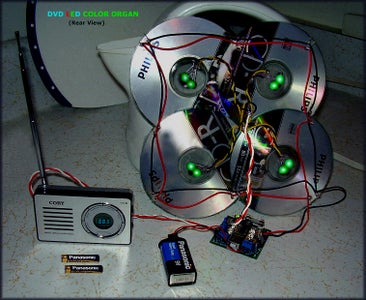

ABOVE (IMAGE #1) is the prototype.
I used a Wireless FM Transmitter which is very small and only requires 2 AAA batteries.
You can get this No-Name Chinese Clone Transmitter on EBAY entitled
“Wireless FM Transmitter” for $5.00 U.S. to your door.
I wanted to transmit my MP3s from the FM Transmitter to a small FM Receiver.....
one which I wouldn't have to putz around with to match the transmitted frequency.
That's when I found the COBY CX50 compact AM\FM Digital Radio on Amazon.ca.
It had a digital FM frequency display.
At only 4” x 2” - it was small, light and just what I needed to easily match the Transmitter frequency.

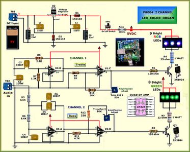

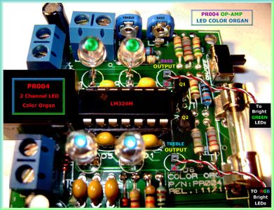

Step 1: The 2 CHANNEL LED COLOR ORGAN CIRCUIT
The LED COLOR ORGAN was the next and most important component to get.
There are some good ones out there – but I wanted one with an op-amp to maintain the 24+ ma current I would need to power my 15,000 mcd RGB LEDs with just a 9 volt battery.
The answer came after watching this color organ in action below.
I obtained this 2 CHANNEL PR004 Color Organ from
http://www.usbekits.com/color-organ---pr004.html
It has 2 Channels – one TREBLE and one BASS.
IMAGE #2 above is the Circuit Diagram for the PR004 LED Color Organ in my project.

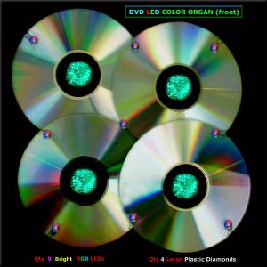

Step 3: The DVD DISPLAY
Finally I had to decide what the DISPLAY would look like.
I had already tested the Color Organ with the RGB LEDs and the colors
and brightness were impressive.
While I was thinking – I noticed a DVD on the table was reflecting a spectrum of light.
So I mounted 9 RGB LEDs on the front sides of 4 DVDs I had overlapped and super glued.
The effect was good in the dark – combining the colors in the RGB LEDs with the
spectrum reflections from the DVDs.
But I still felt something was missing.
The DVD holes just looked empty and I thought maybe I could add something to boost the effects.
In the Dollar Store – I found a bag of translucent large Plastic Diamonds in the Crafts section.
After I glued them into the 4 DVD holes – (nice fit) they reflected some light but not enough.
So I decided to add a pair of Bright Green LEDs to the sides of the plastic diamonds on the back of the DVDs.
That did the trick.
Green light streamed out into the colored lights already producing an excellent lighting effect on the DVD display.
See IMAGE #4 above.

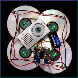

Step 4: BRIGHT GREEN LEDs on the BACK of DISPLAY
IMAGE #5 above shows the pairs of bright Green LEDs
beside the Plastic Diamonds on the back of the DVD Display.
Wiring the BACK of the DVD Display is very easy.
Just add red wires around the perimeter to each of the positive RGB LED legs.
Then add black wires around the perimeter to each of the negative RGB LED legs.
The BASS output of the Color Organ can then be connected to any one
of these RGB LEDs.
Be sure to connect the red positive and black negative wires correctly.
The 4 PAIRS of Bright Green LEDs can be wired together to meet at the center
of the DVD Display.
I used yellow wires for positive and black wires for negative.
Each positive leg PAIR of the Green LEDs are soldered together before soldering
them to a yellow wire..
them to a black wire..
After all 4 Pairs are done - join all ends of the yellow wires together and solder -
then all all ends of the black wires together and solder.
The BASS output of the Color Organ can then be connected to the center of the
DVD Display to these solder points.
(see IMAGE #5 above)

Step 6: VELCRO the DEVICES to the BACK of the DVD DISPLAY
See IMAGE #7 above.
The Color Organ BoardFM Radio and 9V Battery are all small enough to be mounted
on the back of the DVD display with VELCRO – so they can be removed easily if needed.
Finally - just super glue a piece of wire onto the back of the project and it can be
hung on the wall with no wires showing when viewed in the dark.

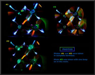

Step 7: PHOTOS of the DVD LED COLOR ORGAN
In IMAGE #8 above....
There are 3 Photos taken of the DVD LED Color Organ...
Two taken in the Dark - and one with one lamp on.
The effects are quite different.
Having just one lamp on provides more spectrum reflection on the DVDs.
Step 8: CONSTRUCTION NOTES:
 NOTE:
For my Project - Resistors R2 and R4 are rated at 1 Watt for heat dissipation of both LED parallel strings as the TREBLE Channel has 9 Bright RGB LEDs and the BASS Channel has 8 bright Green LEDs .
The value of  R12 was changed from 10K to 33K to increase the GAIN of the OP-AMP times 3.
This allowed better response and amplification of the MID/BASS frequencies from the 1 Watt FM COBY Radio.

You must adjust the sensitivity of the Treble and Bass Channels of the Color Organ with the "TRIM-POTS" on the Circuit Board after you set the COBY RADIO to about HALF VOLUME.
Once set - you just need to slightly adjust the Coby Radio Volume only for soft sounds or hard rock.
