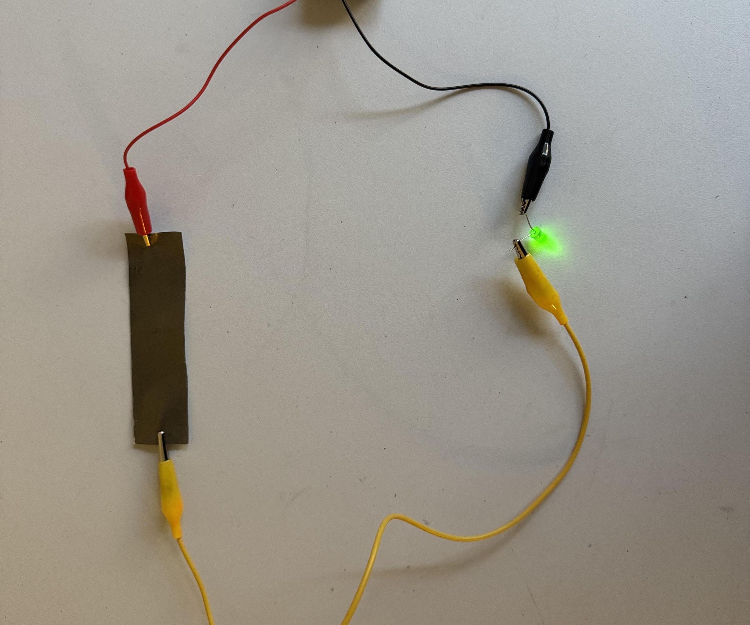

Step 1: The Electron Donor and Acceptor Layers
Cut your FEP sheet into a small rectangle. Then, making sure any protective film has been removed from the FEP, stick the aluminum tape on one side so it covers the entire rectangle evenly. Make sure there are no air pockets between the two materials, and cut off any excess tape.
Step 2: The Base
Making sure the aluminum layer is facing up, use a small piece of aluminum tape to secure one end of the wire to the middle of the rectangle. Then, flip the sheet over so the FEP layer is facing up, and the aluminum layer is on the bottom. Attach your base to the aluminum layer, using tape to secure the connection.
Step 3: The Electrode
Cut out a small 'comb' shape from aluminum tape, like the one pictured above. Use the vertical end of the 'comb' to attach a wire to the FEP side.
Step 4: Testing
Now, if you connect the electrode wire to the negative end of your multimeter and the wire from the aluminum side to the positive end of the multimeter, you can measure a charge when you press the material. To take it a step further, I placed my generator in a small tub and sprayed it with water to measure the electrical output, which was about half a volt. I also tested it out in the rainfall, where a similar voltage was produced.
