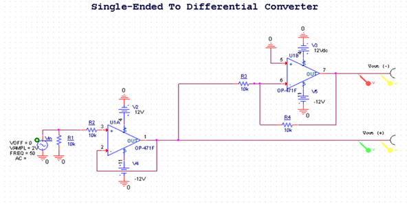

Step 1: Single-Ended to Differential Signaling Architecture

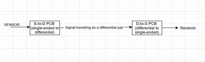

In our system, the sensor outputs—originally single-ended—are initially converted into differential signals. This conversion is achieved by a carefully designed inverter circuit that transforms the sensor’s single-ended voltage into a balanced differential pair. Transmitting the signal as a differential pair is crucial in an automotive environment, where high levels of electromagnetic interference (EMI) and noise are common. The differential transmission allows the system to effectively cancel out common-mode noise, ensuring that the integrity of the sensor data is maintained as it travels over the vehicle’s wiring. At the receiving end, another conversion circuit reverts the differential signal back into a single-ended format, making it compatible with the microcontroller’s analog-to-digital converter (ADC) for accurate measurement and processing.
Step 2: Simulations

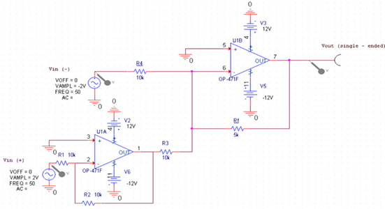

To validate the design, we conducted a series of simulations using SPICE. The SPICE models for both the single-ended to differential (S-to-D) and differential to single-ended (D-to-S) circuits were developed and tested under various simulated noise conditions typical of a car environment. The simulation results showed that the differential signal maintains its integrity over long transmission distances and in the presence of significant interference.

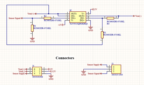

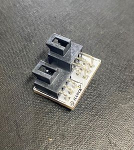

The next phase involved translating the simulation-verified design into detailed schematics for PCB fabrication. The schematics were developed using industry-standard PCB design software and feature two distinct circuit boards.

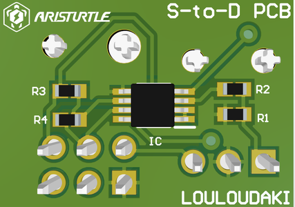

The S-to-D PCB consists of:
1x TLV9352QDGKRQ1 operational amplifier (2-channel)
4x 0603-inch code, 10KOhms, low tolerance resistors
1x 3-pin, nano-fit, right-angle connector
1x 6-pin, nano-fit, right-angle connector

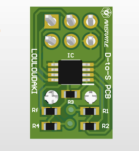

The D-to-S PCB consists of:
1x 0603-inch code, 5KOhms, low tolerance resistor
These are according to the schematics above.
