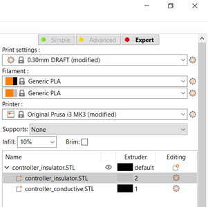

- Import Insulator - Import "Controller_Insulator" by clicking "Add..." and navigating to the file.

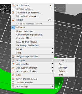

- Import Conductive - Right-click the insulator -> add part -> Load ... navigate to the file and insert it.

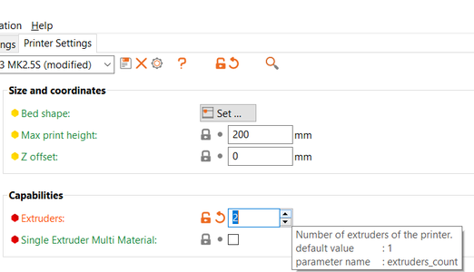

- Add extruder - We'll add an extruder by navigating to Printer Settings -> General -> Capabilities -> Extruders, increase it to two for this print

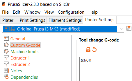

- Add G-code - We need to add a tool-change command to our output G-code, navigate to Printer Settings -> Custom G-code -> Tool change G-code, and add "M600" in the empty box

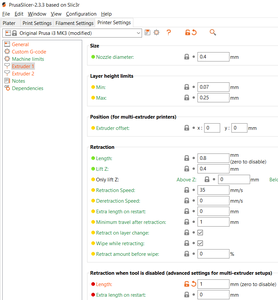

- Shorten Retract length - Navigate to Printer Settings -> Extruder 1 -> Retraction when tool is disabled, change the length to 1mm
- Repeat step 5 with extruder #2.

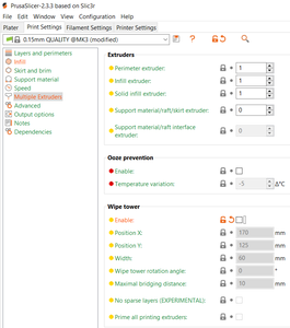

- Disable wipe tower - Disable the wipe tower by navigating to Print Settings -> Multiple Extruders -> Wipe Tower, and unchecking the "Enable" box.
- Assign Colors - Assign the two parts to different extruders in the main "Plater" menu.
- Slice - Click "Slice Now" and send the G-code to your printer.
