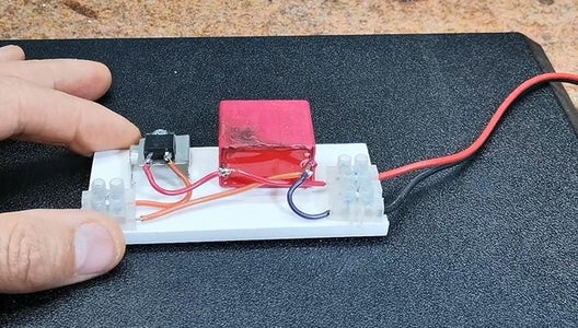

  The drive part consists of several components:
  - adjustable Schmitt trigger oscillator with a range of 50kHz-2.5MHz made with 74HC14 hex inverter IC.
  - tp267 cheap mosfet driver IC.
  - Powerful mosfet I used IRFZ, but it is better to use more powerful IRFP460.
  - a polypropylene capacitor with a capacity of 1 nf or more depending on the tuning.
  - 7805 CMOS IC power supply stabilizer
  - 12V power supply for the oscillator and mosfet driver,
  - and to power the mosfet and the primary coil, instead of full wave I use a half wave single diode power supply with a small 1µF filter capacitor primarily due to the fact that I could not use an interrupter due to the lack of an Enable pin on the mosfet driver IC.

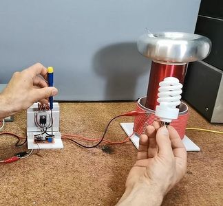

 If you want to ideally adjust the Tesla coil, you definitely need a two-channel oscilloscope and a lot of patience. The setup method is explained in detail on the original project page. I will explain the basic setup procedure, assuming we don't have any instrument. First, we apply a voltage of about twenty volts to the mosfet, and with a CFL bulb close to the transformer, we turn the potentiometer until the bulb lights up. We keep spinning until we get maximum intensity.
Next, we change the number of windings of the primary also looking for the highest intensity of the bulb, but we should keep in mind that the number of windings should not be less than 3 or 4 because of the excessive current that can flow through the mosfet. Let the polyester capacitor that forms the E class be a few (4.7) nanofarads, and then we can experiment with smaller values. Now we can gradually increase the voltage, controlling the temperature of the mosfet. In my case, the maximum voltage for reliable operation of the device was about 75V.

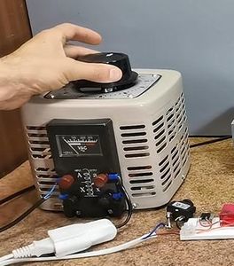

 Let me mention that the use of a variac when testing any Tesla Coil is of great help, not only in terms of testing, but also saving relatively expensive semiconductor elements, so if we want to go a little more seriously in this area, the variac is the most important component.

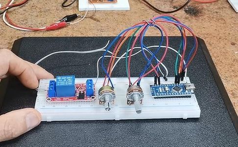

 At the beginning I mentioned why I couldn't use a classic interrupter, so I made a very simple Arduino project with a relay and two potentiometers that can be used to change the duration of the pulse and the pauses between the pulses.
In this way the contacts of the relay periodically interrupt the power supply from the oscillator and act as a kind of mechanical interrupter. Due to the slowness of the relay, the maximum frequency of this interrupter is limited to a few hertz.
