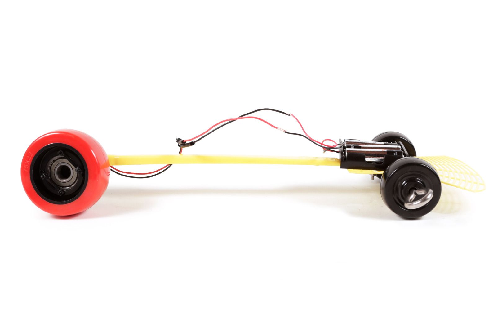

This 'straight forward' Single Motor Bot is a classic example of a Simple Bot. It is like a robot in many ways, but lacking in intelligence, and responsiveness. Nevertheless, bots like these are great springboards for jumping into the wild world of robotics. If you can build this, you are a long stride towards building your first full-fledged robot.

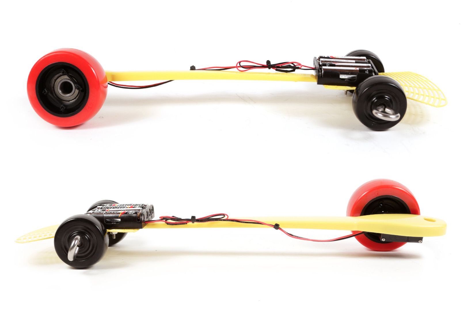

Step 7: Shape the Fly Swatter
The fly swatter is going to serve as the frame or "body" for the bot. Since it is still a fly swatter and yet, a bot, it not entirely a perfect fit quite yet. It needs to be shaped.
We will be mounting the turnbuckle wheel axle where the handle meets the paddle. Basically, we want to make cuts such that the wheels can spin freely when the axle is centered. To do this just get a pair of scissors and trim away enough of the fly swatter to allow for this.
Also, don't forget to keep in mind aesthetics! Like anything else in life - having style is classy. A simple thing to go for is simply to make sure the two sides you are cutting mirror one another. You can also try following the patterns on the swatter itself.

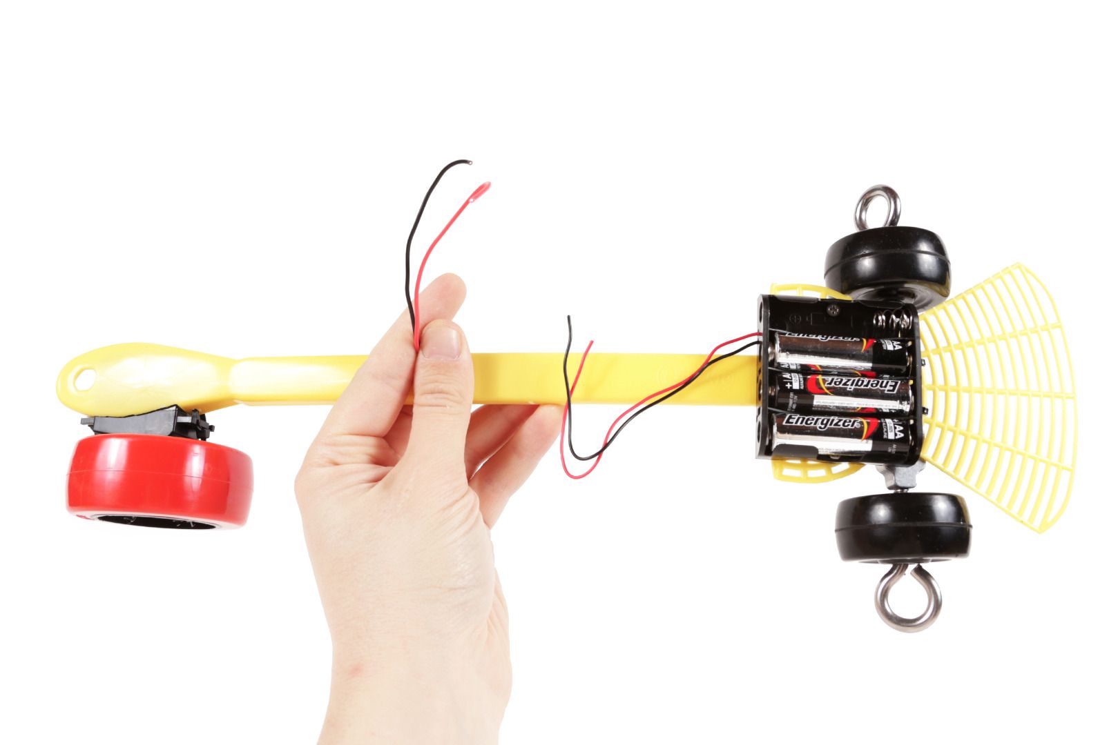

Step 11: Attach
Attach the motor to the frame using zip ties. Pull them as tight as possible, and then trim away the excess tails.
Step 12: Attach the Wheel
Insert two zip ties both down through the wheel, and the corresponding holes on the servo horn. Next, pass each respective tail back up through the servo horn and the wheel using one of the two free holes. Once passed through, fasten the wheel tight.
You may do this and realize your zip tie is not long enough. Fret not. This is an easy problem to solve. Just slide the head of a new zip tie on the tail of the last. You have just extended it. Now you can now close it pull it tight like you would any other zip tie.
Again, trim way any unnecessary excess plastic once the wheel is completely attached.
Step 13: Attach the Axle Shaft
By now you may be beginning to notice a trend. Most things are easily attached using zip ties. The reason I like using zip ties is that they are strong, cheap, relatively small, and easy to undo. You can zip tie two things together, decide you don't like it, and undo it rather painlessly. Zip ties are both a quick way to protoype and make structural joints. They are fantastic, and we will continue to use them extensively throughout these lessons.
Anyhow...
Zip tie the turnbuckle wheel shaft to the underside of the fly swatter such that the wheels are able to spin freely.
Step 14: Mount the Battery Holder
The one part that does not get attached with zip ties is the battery holder. Bolts are used to mount the battery holder because battery holder tend to have mounting holes directly below the batteries. Using zip ties will push the batteries upward and cause them to pop out. This is no good. There is typically not a good or easy way to zip tie battery holders down without interfereing with the batteries. Bolts are typically the better option when dealing with these.
The use of washers is optional depending on the size of the holes in the swatter. Initially, I thought I might have needed them, but it turned out they were not necessary. If the holes in the swatter turn out to be bigger than the size of the 4-40 nut, you will need to use them.

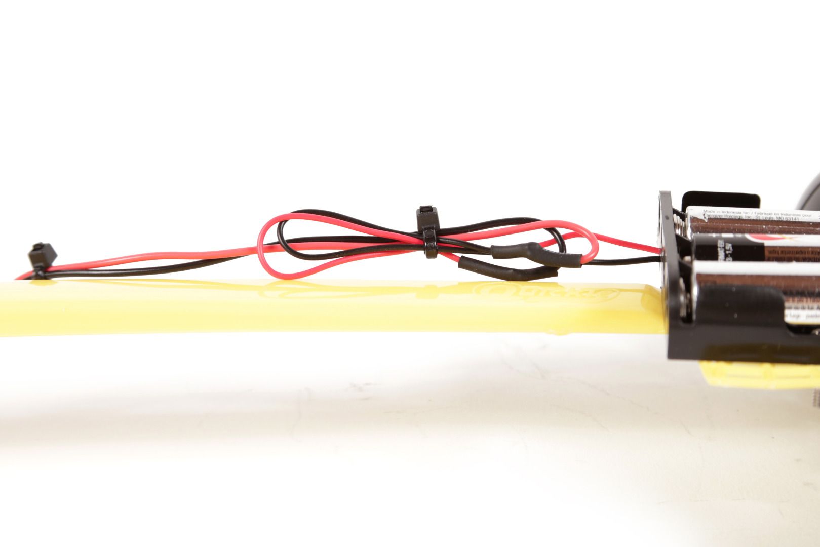

Step 15: Clean Up the Wiring
It is good form to bundle of the loose wires and tidy them up using zip ties. This helps to prevent them from snagging and breaking.

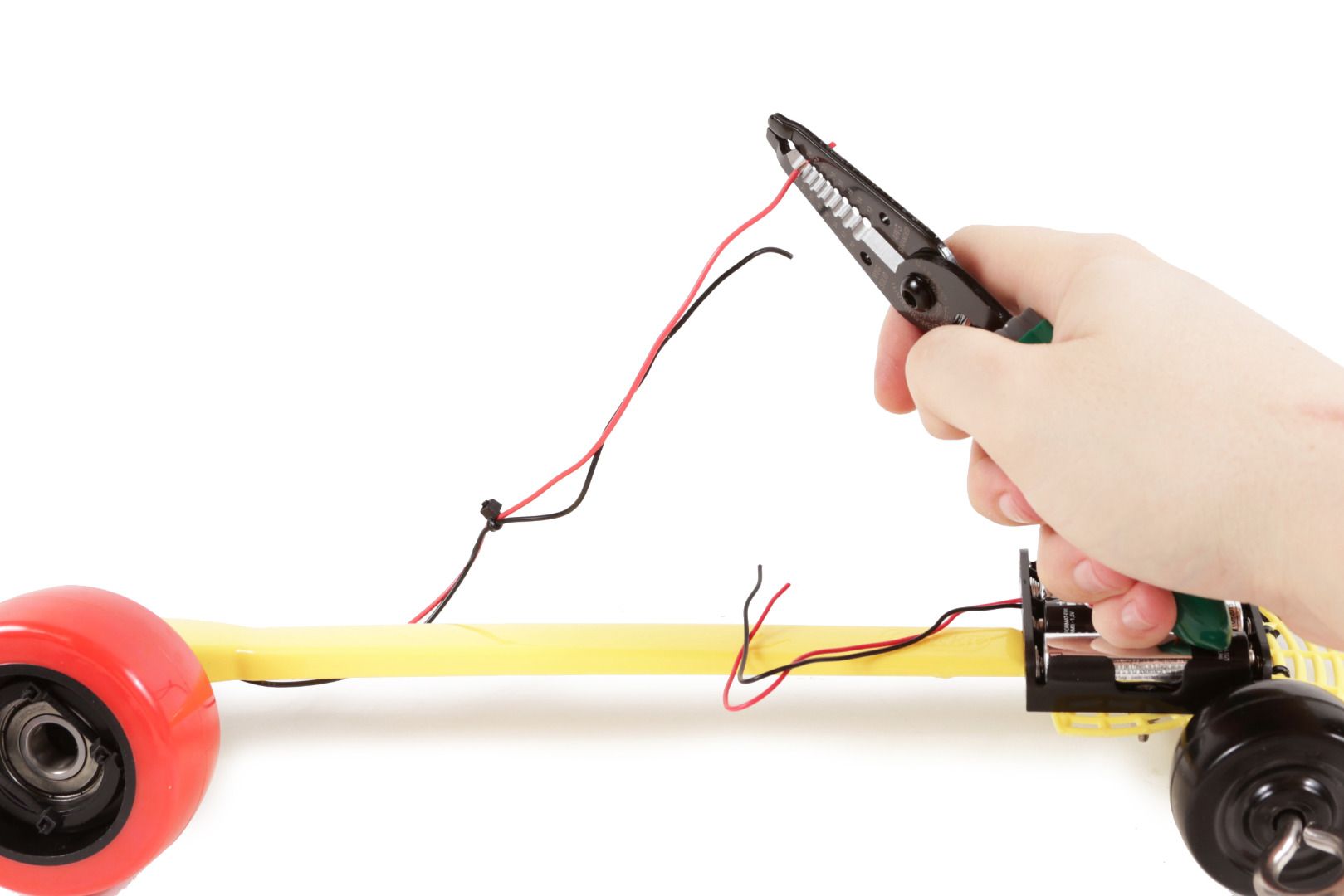

Step 17: Troubleshooting
If you followed my instructions to a 'T' you may currently be noticing your bot is going backwards!
Normally, I would have gone back and corrected my instructions so that everything worked perfectly the first time, but after thinking about it for a moment, I decided there was a teachable moment here.
First off, maybe it's not actually going backwards. Maybe that is the way you wanted it to go to begin with. In which case, you are done. Congratulations.
Or maybe it is not the way you wanted it to go, but you like it better like this. In which case, celebrate happy accidents, and pat yourself on the back.
Or perhaps - like me - you wanted it to go the other way and this is annoying you.
If this is the case, let's try to figure out what is going wrong.

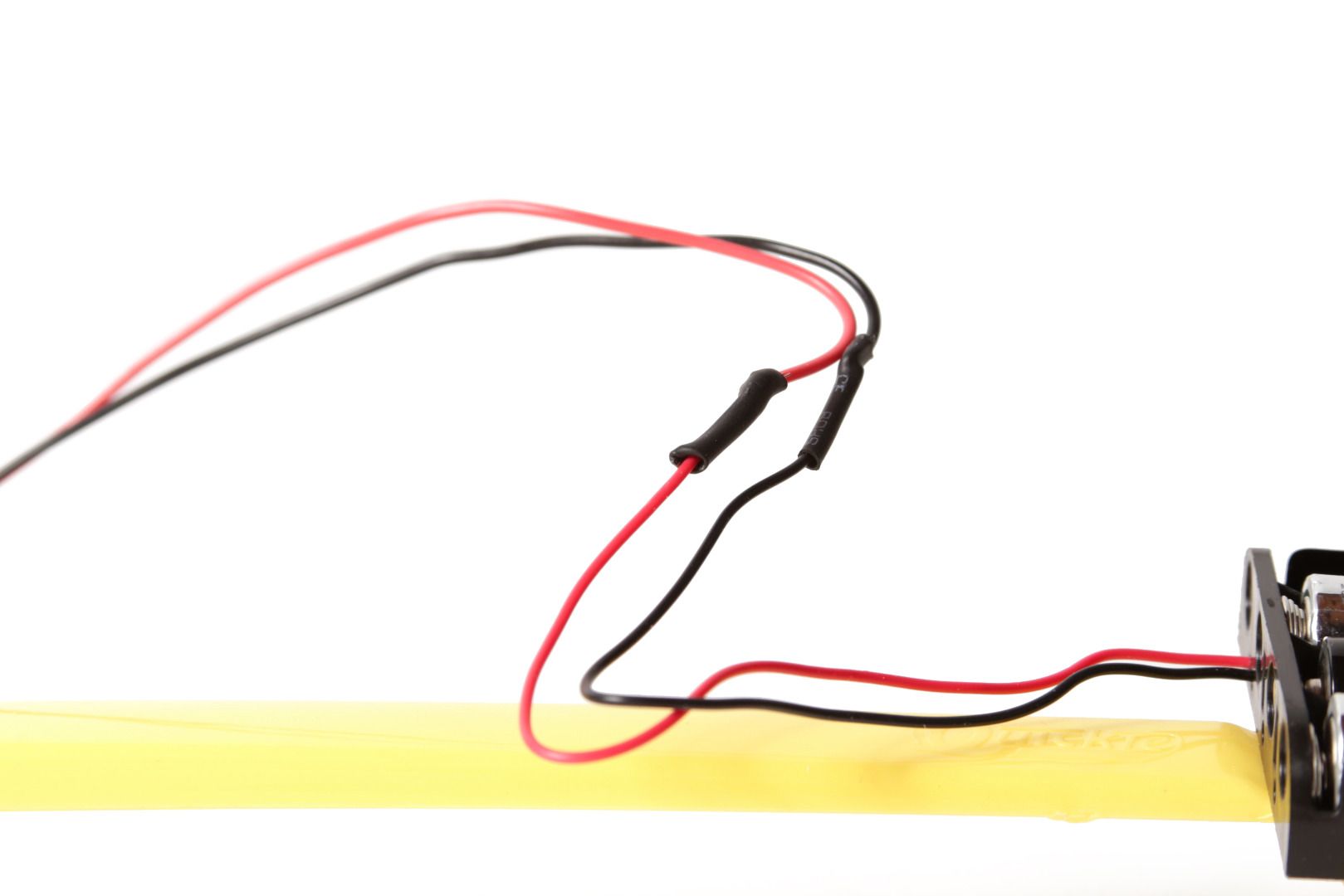

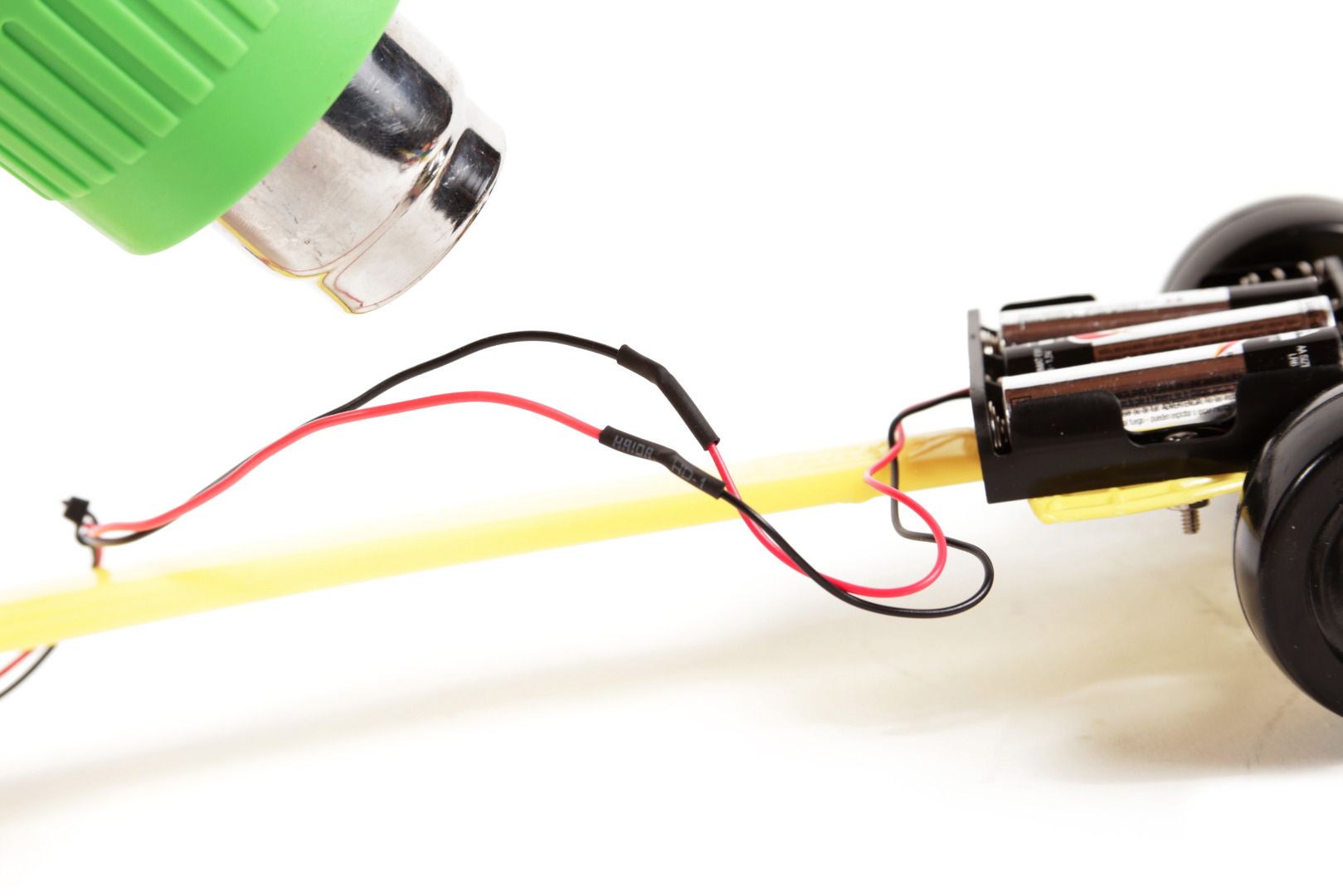

Remember that the direction of a motor is determined by the polarity of the power supply connected to it. So, if the motor is spinning the wrong way, that means that power and ground need to be reversed. This is simple to do with a little rewiring.

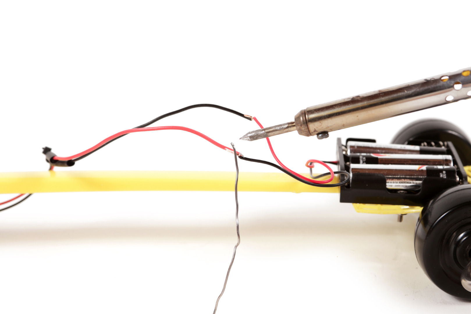

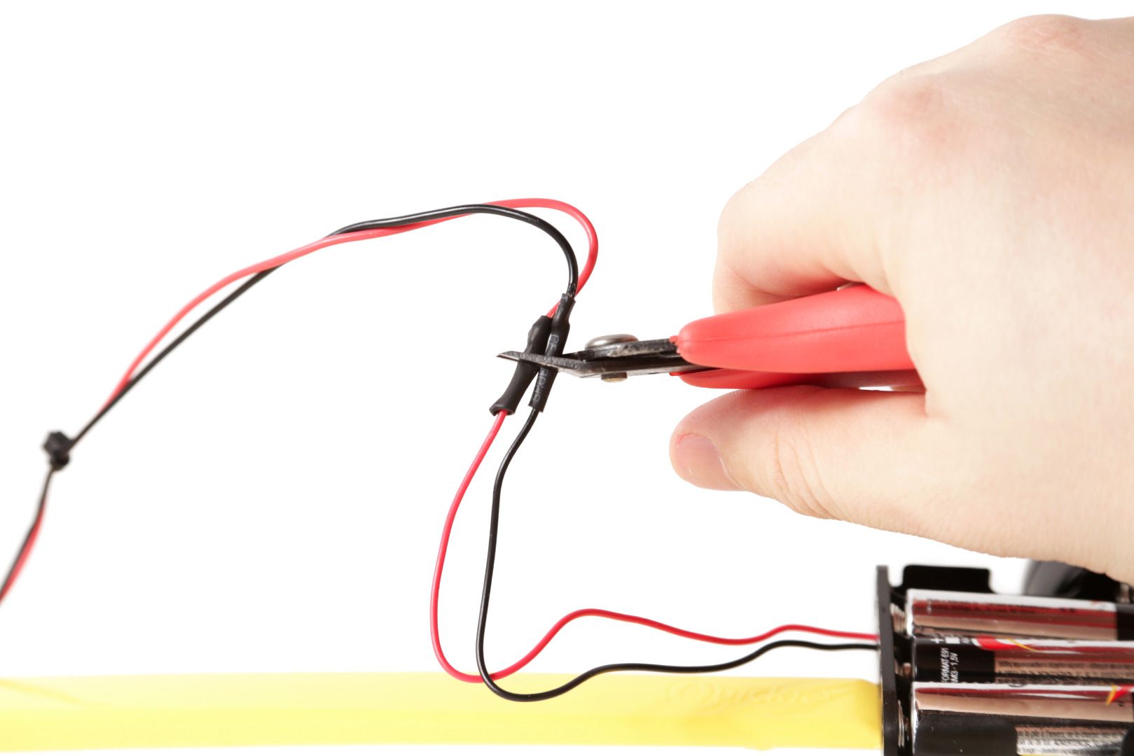

To begin, snip the wires, and clip away any of the old solder connections.

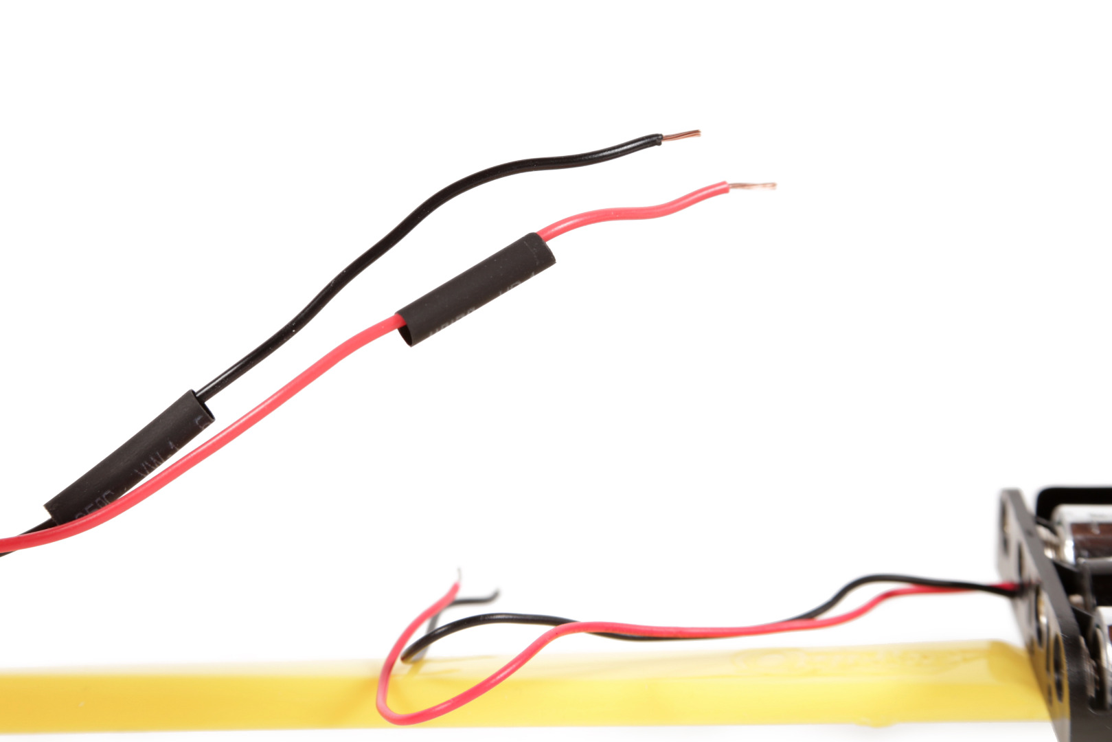

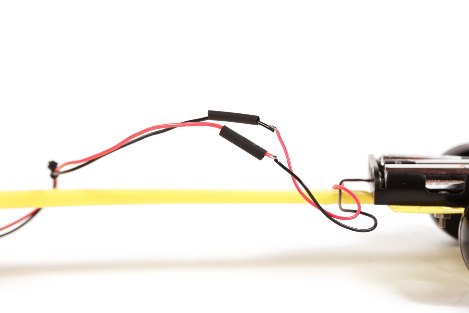

Strip the ends of all the wires, add some more shrink tube, and then solder them red to black, and black to red.
Make sure they are nicely insulated with shrink tube.

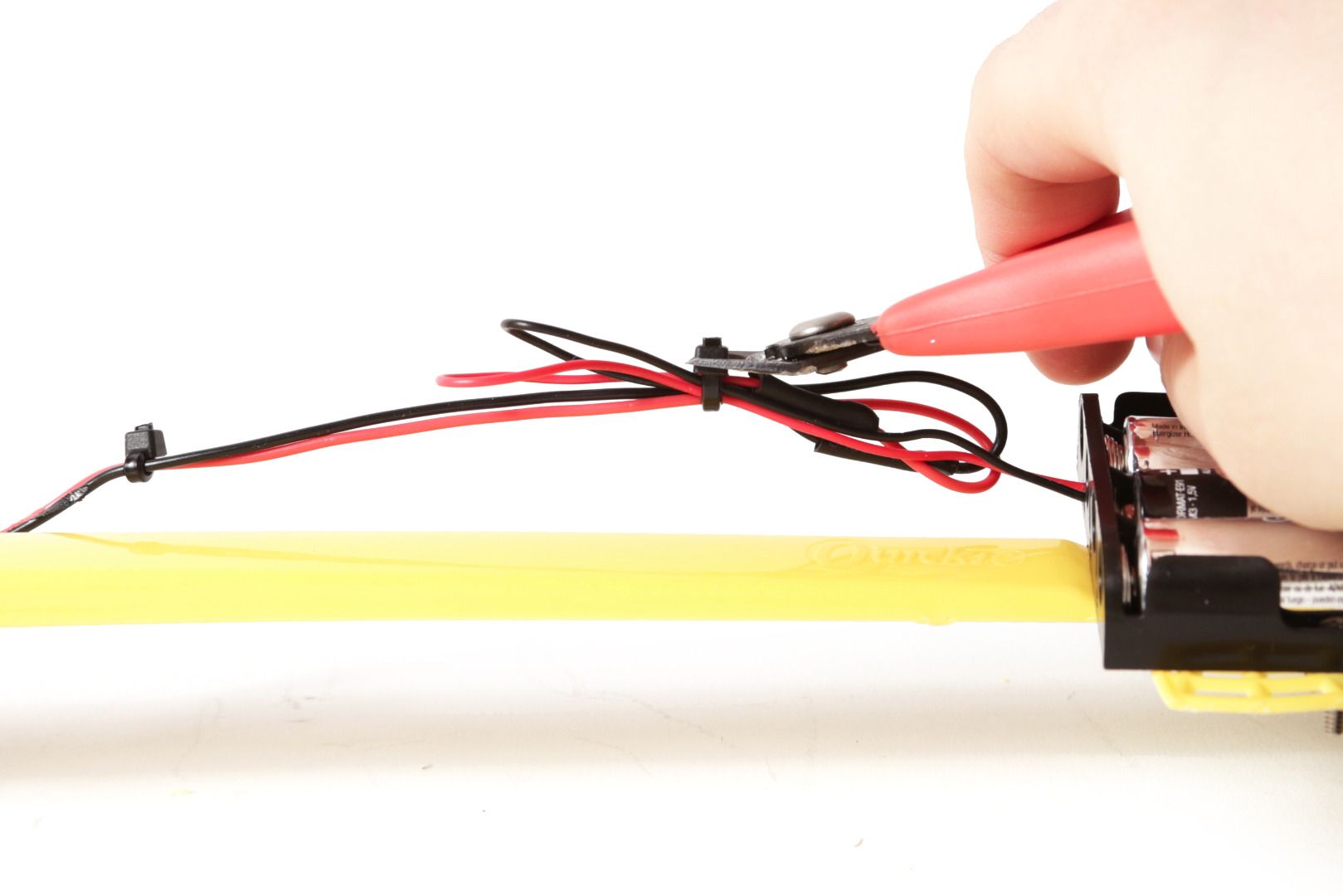

Lastly, clean up the wiring once more with a with zip tie.
The problem should now be solved.
To avoid this problem in the future, simply check polarity and orientation before you solder the wires and mount the motors.
