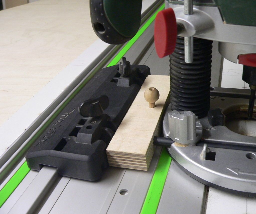

Step 4: Building a Jig
I bought this Ikea style connectors and needed a jig. It will wear out but it did the job. I apologize about the ugly handwriting on the jig. You need some scrap wood, a 15 mm Forstner bit, a 8 mm and a 5 mm drill bit. The 15 mm hole is located on the center line and 34 mm from the fence. The 5 mm hole is also on the center line but only 9 mm from the fence. The two 8 mm holes beside the center line are 4 cm apart. (Pictures 2 and 3).
Next you had to drill 8 mm holes through the fence part. One on the center line, two 4 cm apart from the center line. Be as accurate as you can.
Step 5: Using the Jig
Mark your connection point on the boards where you want to connect them. Drill the 5 mm and 8 mm holes on top (Picture 2). On the matching part of the connection drill the 8 mm and 15 mm holes through the fence and on top (Picture 4). The center hole got the metal dowel. All other got wooden dowels.
