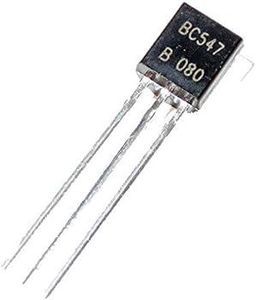

The transistor used can be any NPN transistor, I used a BC547.
