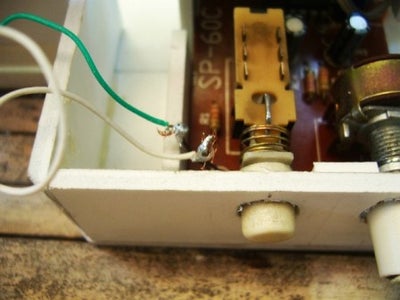

Before assembling the dock, make a hole for the volume control and power switch in the front part of the dock casing.
I solder another av jack specially positioned for ipod nanos (1st, 2nd and 4th generations) and ipod shuffle (2nd generation).
I also change and relocate the led (see photos). Have a test if the jack is properly working.
