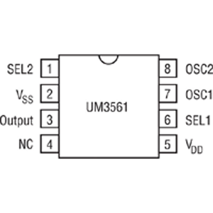

Step 1: UM3561 Pin Diagram and Description
Pin No. Symbol Description
1 SEL2 Sound Effect Selection Pin No.2
2 Vss Negative of Power Supply
3 OUTPUT Mono-tone Output
4 NC Internal Testing Pin : Leave Open for Normal Operations
5 Vdd Positive of Power Supply
6 SEL1 Sound Effect Selection Pin No.1
7 OSC1 External Oscillator Terminal 1
8 OSC2 External Oscillator Terminal 2

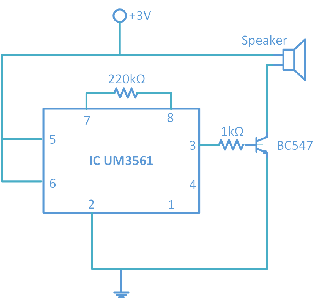

So as per the table above, we are going to create these 4 circuits. The components required for all these circuits are listed here:
IC UM3561
Transistor BC547
Resistors – 220k and 1k
Speaker – 8 Ohm
3V Battery

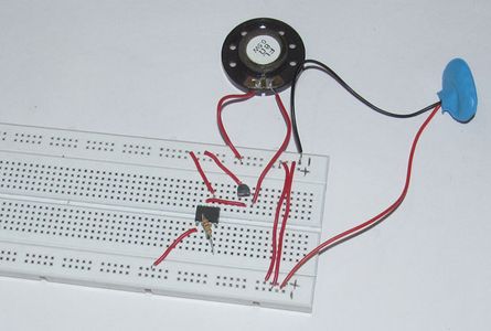

Step 3: Police Siren
To create a police siren circuit you need to create connections as per shown in the below circuit.
Steps:
  • Adjust IC UM3561 on middle of the breadboard.
  • Leave pin 1 unconnected and connect pin 2 with ground pin battery.
  • Connect pin 3 with the base of transistor BC547 using 1k resistor.
  • Connect the negative end of speaker with the collector of transistor and positive end with the positive end of battery.
  • Connect emitter of the transistor with ground battery.
  • Leave pin 4 unconnected and connect pin 5 with the positive of battery.
  • Leave pin 6 unconnected. Connect pin 7 and pin 8 using a 220k ohm resistor.
Step 4: Fire Force Siren
The components required and basic connections of the circuit remain same. Just connect the pin 6 of IC with the positive end of battery and siren selection will change from police siren to fire brigade siren. This configuration can be used in a simple circuit like this fire alarm circuit to make it more interesting and useful.
