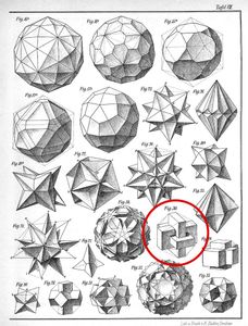

Plates from the book: Max Bruckner, "Vielecke und Vielflache" (Leipzig, 1900)
We find the first illustration of such a model in a book by the German geometer Max Bruckner (1860-1934). The book " Vielecke und Vielflache ", published in Leipzig in 1900. It was the first to publish a drawing of a polyhedron model based on the intersection of three golden rectangles.
