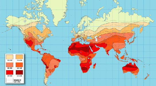

Step 5: Solar Array
Now that we know all of our loads we can work our way out to the solar array.
This a may be an array of cells in a panel or an array of panels.
The number of panels required in the array is dependant on some more variables.
These are:
  • The loads and losses as previously calculated
  • The efficiency of the panels
  • The geographic location of the panels with respect to solar irradiance (the amount of sunlight that will fall on a given spot)
  • The inclination and rotation of the solar panels
  • Any shading, dirt or snow causing losses in the array itself
No power generation system is 100% efficient, in fact with solar panels the efficiency is quite low only about 22% of all the energy they collect is converted to usable power.
The angle and orientation of the solar panels vary by location, this page will help you set the optimum angle for fixed solar panels for your area. Tracking systems may be used, but they use some of the power and may actually require additional panels just to power the system.
Ambient temperature will also affect how efficient the solar panel is at converting solar to electrical energy, if you are feeling like a bit of reading, this paper explains the relationship in a few short equations.
