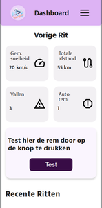

Frontend (HTML, JS, CSS):
  1. The web dashboard runs locally on the Pi and is accessible via browser.
  2. It displays:
  3. Live session data
  4. Brake events
  5. GPS route
  6. Sensor data visualization (e.g., using Chart.js)
  7. Communicates with the backend for real-time updates.
