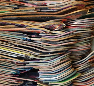

Colorful Skateboard Decks or you can buy pre-made blanks

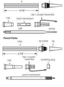

Pen Kits (These guys have thousands of kits)

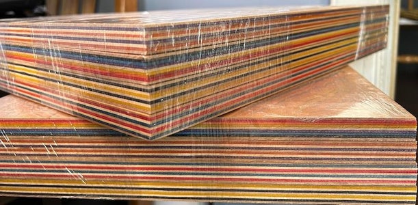

A. Glue up of skateboard decks to create a plywood like board at least 2" thick, 4" wide and 10" long.
B. Cut this board into 1"x1"x 8-10" blanks.

Step 7: Assemble and Admire
A. Follow the instructions of your pen kit to assemble your one-of-a-kind pen!
