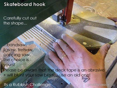

Step 3: Cut Out Shape
Cut out the hook shape from the deck.
I used a small bandsaw taking care to roll the shape to keep the deck flat on the bandsaw table at all times.
A jigsaw would work as well or even a fretsaw or copping saw. Just use the best tool you have to hand.
The deck tape is abrasive and will blunt your blade, make sure you use an old one.

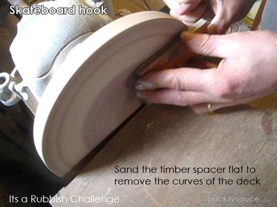

Step 4: Spacer Block
Next make a spacer block to give enough room for the skateboard to hook on.
Mark out on a scrap of the deck where the four truck fixing holes comes to. Shape the spacer larger than these holes though I set the final shape about 5mm back in from the edge of the hook.
Remove any deck tape, just get a blade under it and pull off.
Sand the spacer flat. Skateboard decks, as I am sure you know, undulate and we need this spacer to be nice and flat to fit flat against a wall.
Drill and countersink two fixing holes centrally to the spacer one above the other. This allows for fixing the hook securely to a timber stud.
Pre-fix the hook to the spacer through the four truck fixing holes.
If your screws poke out the back of the spacer [as mine did] snip them off flush.
Remove and save for later fitting.
