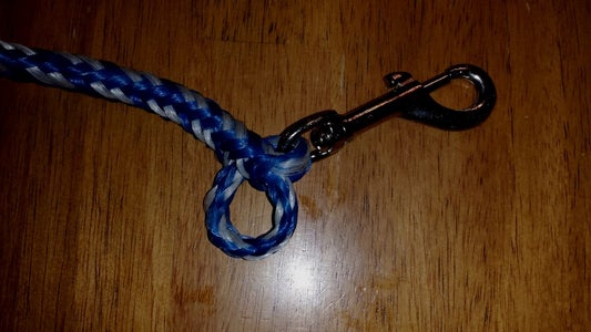

Step 2: Tie the Knot on the Snap
While disassembling the ski rope, I discovered that every knot was made in the same elegant way. They were self-tightening, and neatly tucked the tag end into the center of the rope, which forms a tube made of many strands. Too make the knot, first sharpen the end of the rope with scissors to make a point on it. This step will make it easier to complete the knot. Pass one end of the long rope through the eye of the snap swivel. Be sure to use the swivel type of snap so that any twist that develops in the lead will be relieved by the swivel. Part the strands and make a gap about four inches from the end. Pass the tag end through the gap and out the other side of the rope. Part the strands again about one-quarter inch upstream and pass the pointed end into the center of the rope downstream past the first crossing. Tighten up the knot.
