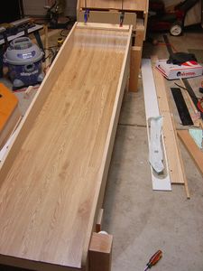

Step 3: Side Panel and Ramp / Alley Assembly
The two side panels are attached to the inner frame. Foot braces are added for solid base support.
The cross beams will support the alley ball rolling board. Now the ball return, which will be completely a gravity fed system, as you can see in Picture 2 are rails sloped down. A plywood board will rest on those rails under the alley board for a ball return as pictured. Now, how to control the balls coming down the board? TRACKS. Picture 4 shows a test placement of the alley board.

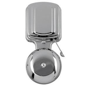

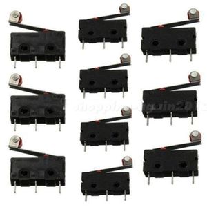

I used Black lawn edging material (thick, heavy duty and ridged) to form the rings which guide the balls that miss the rings. Again, using L brackets to secure the edging to the plywood/cork board. I wanted a 'bell ring' when each ball dropped in a hole. So I got 6 micro pressure switches (very inexpensive) and cut holes in the bottom board where a ball would first land thru the cup. I mounted the micro switch so just the lever was sticking proud of the surface. I wired all the switches in parallel to a wall wart and a 'clapper' style bell.. A test run, with dropping a ball in, I found that the bell did not ring long enough. So, as pictured, I screwed in some Styrofoam strips so the rolling ball would keep the lever down longer. I also constructed the cabinet to hold the entire head unit using wood rails inside to cradle the target board at the proper angle.
