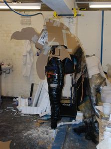

Step 1: The Mock Up.
I find the best way to start any project is with a mock up. The great thing about mock ups is they are generally cheap, if not free to do.
When you're making a costume, it's always best to start with a dummy of some sort. A duct tape dummy is the best option, as it is a fairly accurate clone of your own body.
Once your dummy is in place, just start placing card cut outs over the dummy, taping them in place. If something doesn't fit, just add or subtract card until you get the right size.
Keep all the pieces of mock up, as some will come in hand later as templates or sizing guides.

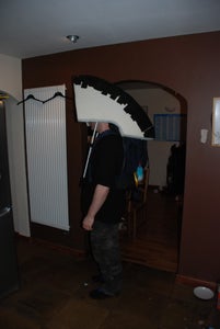

Step 2: Frame and Foam.
Next we need to make a frame for the whole thing to sit on. Since this costume obviously doesn't fit a human form, the frame needs to be larger than your body, and form a sort of tent.
This stage is quite time consuming, and shouldn't be rushed. getting the frame and base perfect is what will make the costume work.
To attach the framework to your body, a good sturdy backpack does the trick. Don't be tempted by a cheap option, as the final weight of the costume is likely to split stitches and cause a cheap backpack to disintegrate. The back pack MUST have a belt strap to it.
You will also need to make some small pockets for the rods to sit in. I used regular webbing for this, and hand stitched it into a pouch with a belt loop. Make two of these and slip them onto the backpack's belt. the frame's rods them slip into these and everything should be supported happily
For the upper solid part, simply make a structure from firm foam. I found some plastic backed foam at my supplier which was perfect for the job. Make sure you glue this solidly with something like impact adhesive (you really don't want this to give in on you mid-wear), then add a front to the whole structure, also in foam. Finally, add a nice chunky foam "peg" that will sit in the backpack, and keep the upper structure in place.

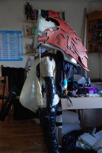

Step 4: More Foamwork, and Building Up the Shape.
Now attach your dummy to a solid, well weighted object (I used the dining room table, but bear in mind, you'll put whatever you use out of action for a good long time!). Next, add everything to the dummy, and make sure everything fits. You may need to cut down the support rods so they fit at the correct height.
It's worth making mock up parts like the carapace in the photo. These can fill in for major parts you make later, and also serve as guides when making those parts. The mock up carapace in this shot was made freehand from Plastazote, and painted.
To further add to the shape of the costume, make a "belly" out of foam, and cover it with cheap Satin. (you may have guessed, you'll use a lot of this stuff!) This is then attached by making a simple reverse backpack strapping, but only make a shoulder strap for your offhand. This is to keep your main hand free to control the head.
