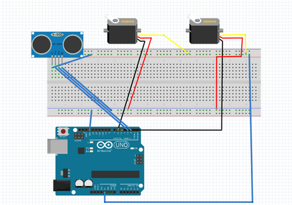

Step 1: Electronics
To build the circuit you will need the following components:
Electronic parts
PCB
Arduino UNO
2 servo motors - Micro Servo 9g [DF9GMS]
1 ultrasonic sensor - [HC-SR04]
Cables
2 screws from the Arduino kit
Step 2: The Code
The following code designed with the Arduino software associates the servo's movement with the distances detected by ultrasonic sensor.
