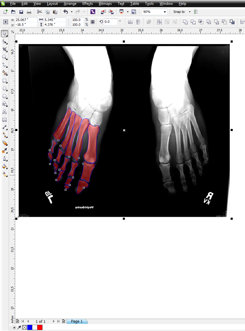

Find an x-ray photo online or use your own.
Import the photo in to the file, you will use this as a guide to trace the bones or you can wing it and draw the bones by mouse/tablet.
Step 4: Stylize Your Final Design
Finalize your design layout and spread out the design to define the toes.
On the left you will see the initial tracing in transparent red with a RGB blue outer line. I did this to make it easier to see where I was tracing.
The tracing is fine, but there are some overlapping areas. Additionally, the toes could be more pronounced so that they fill the entire vamp area.
