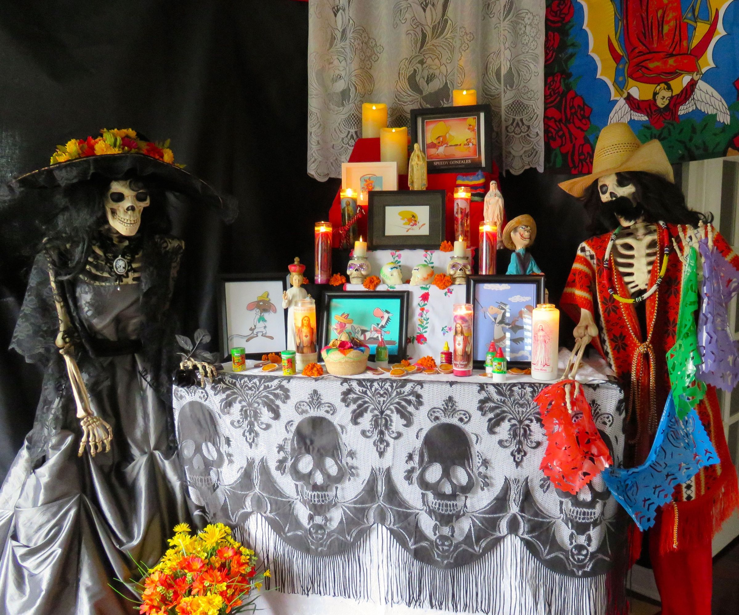

Since I was dressing all my skeletons in Halloween apparel, I didn't worry too much about hiding how I was attaching them to the stand. I simply used packing tape (duck tape would work too, but may leave tape residue) to secure the skeleton. I wrapped tape (a few revolutions) in 2 places: ribs and legs (see photo.)
Step 5: Enjoy and Decorate Your Standing Skeleton
Dressing the skeleton is fairly easy.
For dresses, simply put over the skeletons head and secure with binder clips in the back if the dress is too large.
For pants, I removed the scaffolding (with the skeleton attached) pulled the pants on, secured the waist of the pants with binder clips, and put the PVC pipe back over the nipple. I was able to do this alone, but if you have a friend to help guide the PVC over the nipple...it makes it easier.
More than one skeleton...
To attach more than one skeleton to a base, simply make the base longer. The rest of the steps remain the same. Make sure you allow for any clothing and/or prop clearance between skeletons. The base that we made for 3 skeletons was 5' long.
