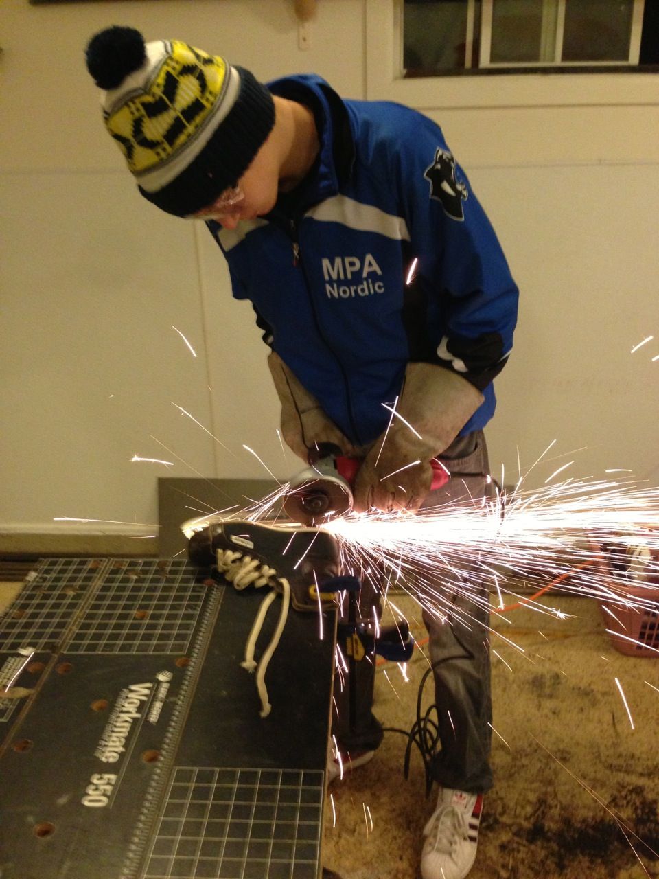

I made a ski rail for this with a Instructable coming soon. I also took a old bmx bike frame and a old pair of skies to make a skike or ski bike, it works really well supriseingly.

9 years ago on Step 9
nice ski bike!
