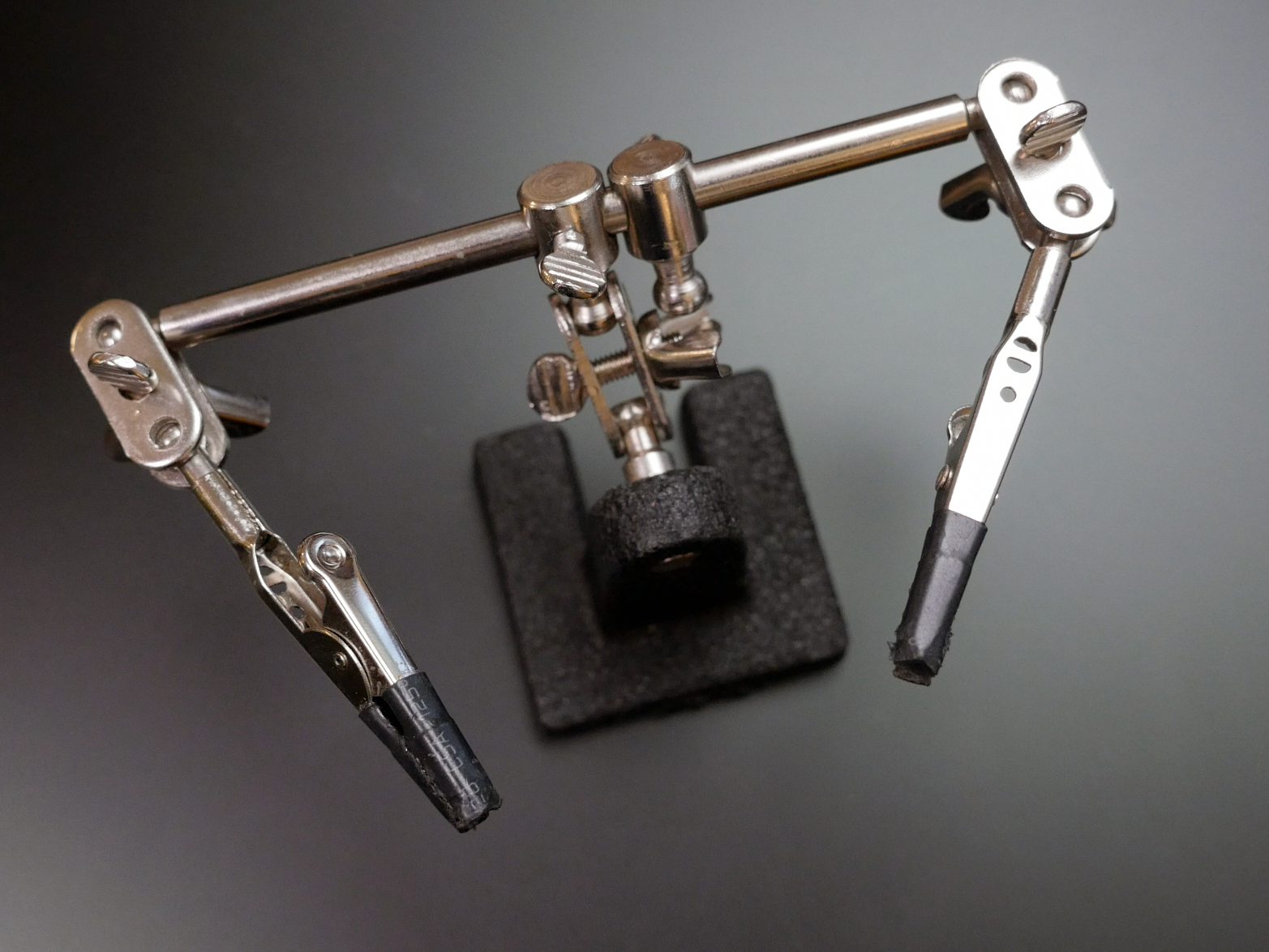

A third hand tool helps immensely when it comes to stabilizing your work, especially as you're learning to hold the iron steady. I tend to avoid caffeine around workshop time, too. I like to put a little bit of heat shrink tubing over the jaws of my third hand tool, to soften its bite.

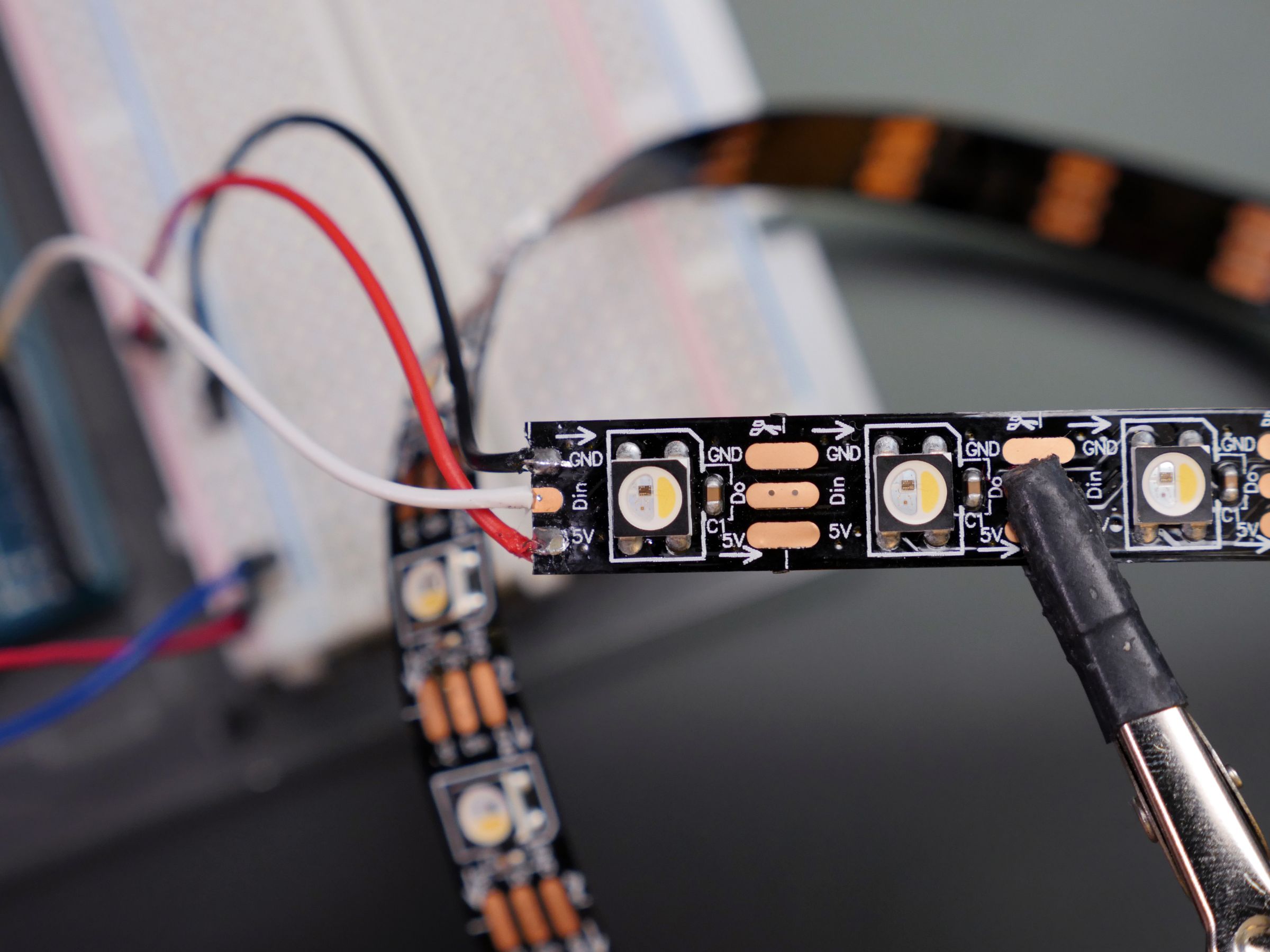

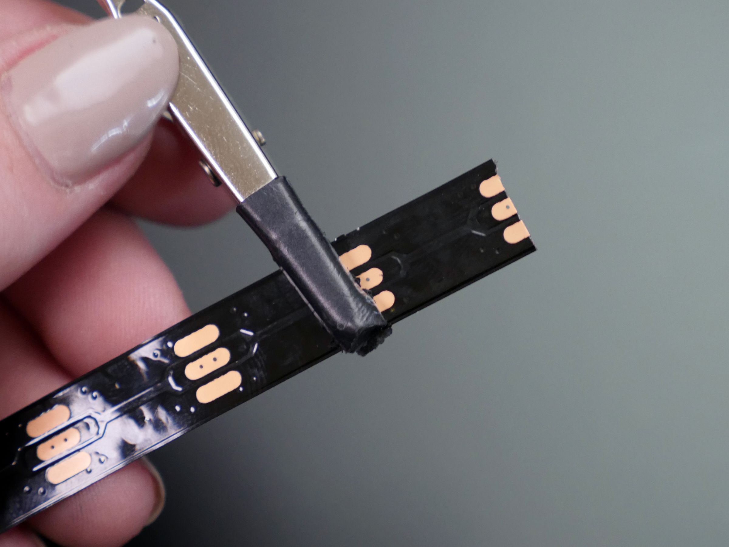

Prep three of your breadboard wires by cutting off the connectors at one end and stripping the ends to expose the bare strands of wire. Twist the strands of each wire to keep them together, then heat up the wire with your soldering iron and apply a small amount of solder. Remove the solder before removing the iron, to give the molten solder one last moment to settle in. Repeat to tin your other two wires, then set them aside.

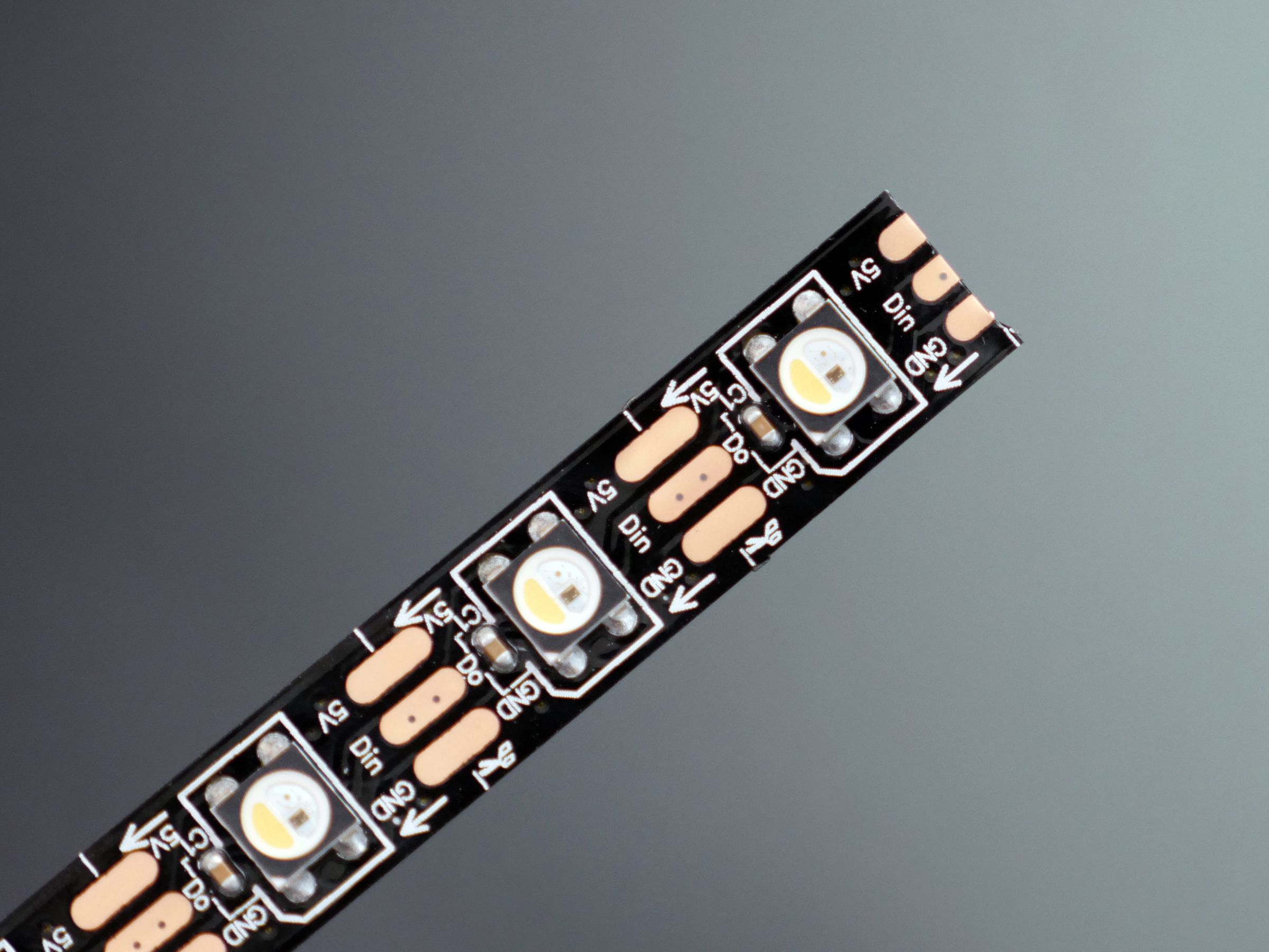

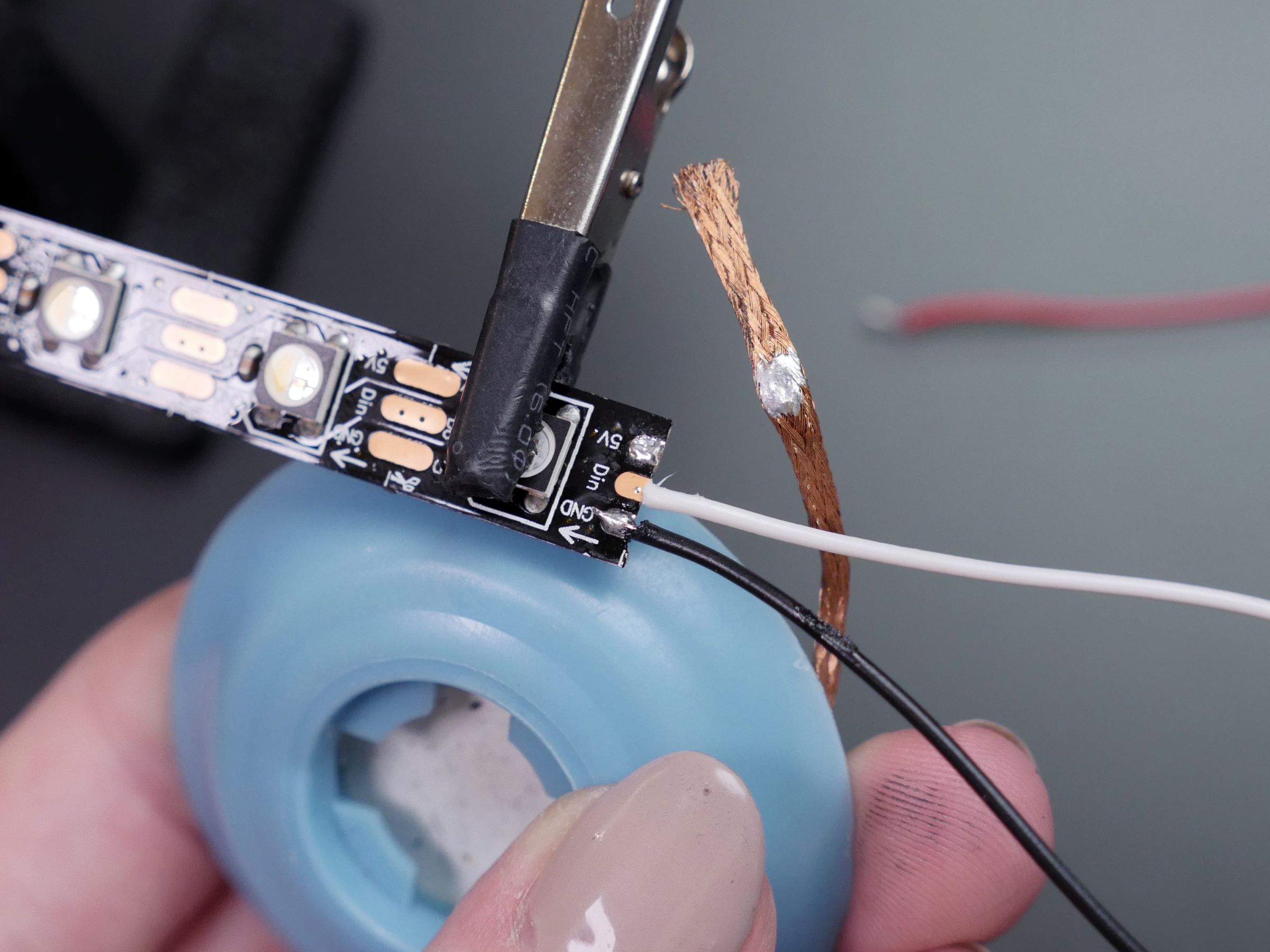

Cut a piece of your NeoPixel strip 19 pixels long, using your flush diagonal cutters to clip straight across the middle of the copper pads. Remove it from the silicone sheathing and identify the input— the arrow markings on the strip point away from it. Clip the input end it into your third hand tool with the back of the strip facing you. Tin the center copper pad by touching your soldering iron to it, then applying a small amount of solder. Move your tip around the copper pad to spread the bead of solder around.
Now that your two components are tinned, it will be easier to solder them together. Pick up your white wire in one hand and your soldering iron in the other. Hold the tinned wire end to the tinned copper pad, and reheat the two components at the same time. The solder on each should flow together, if it doesn't, you may need to apply some more. Remove your iron before letting go of the wire, so the solder has a chance to cool, securing the wire in place. If you find it difficult or too hot to hold the wire with your fingers, use a pair of tweezers or pliers.
Flip over your NeoPixel strip and similarly tin and solder wires to the other two copper pads (red wire for 5V, black wire for GND). It doesn't really matter which side of the copper pad you solder to, but alternating sides gives your solder joints a little more elbow room. Trim any excess wire protruding from the copper pad. Now you're ready to plug the strip into your breadboard and get the LEDs glowing (we'll do that next)!

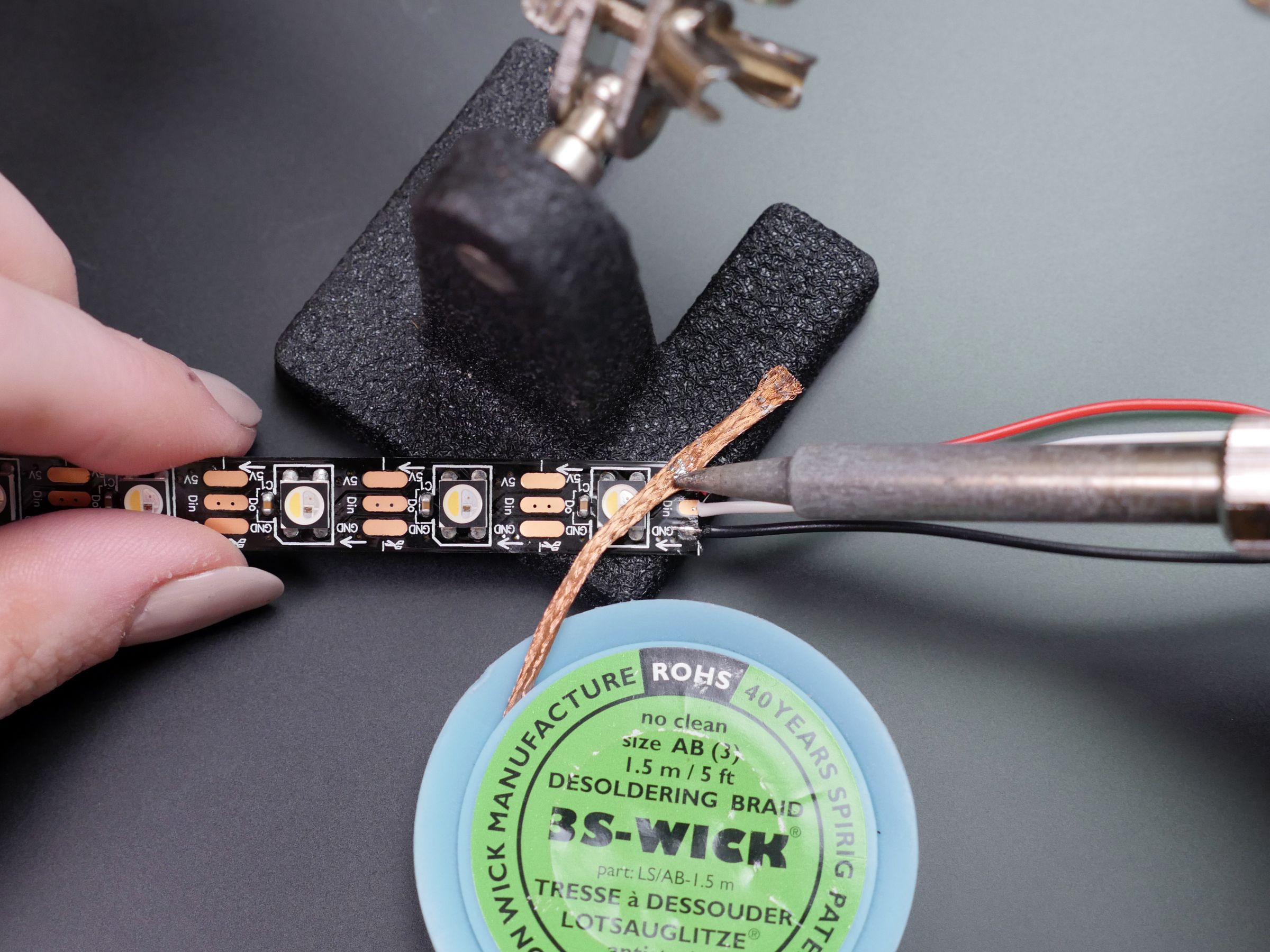

If you make a mistake, apply too much solder, or just want to disassemble your work, you can desolder the joint by simply reheating it and pulling the wire away. For more entangled components, you can use copper desoldering braid to remove excess solder (its highly interleaved surface area draws the solder in with capillary action), or a suction desoldering pump.

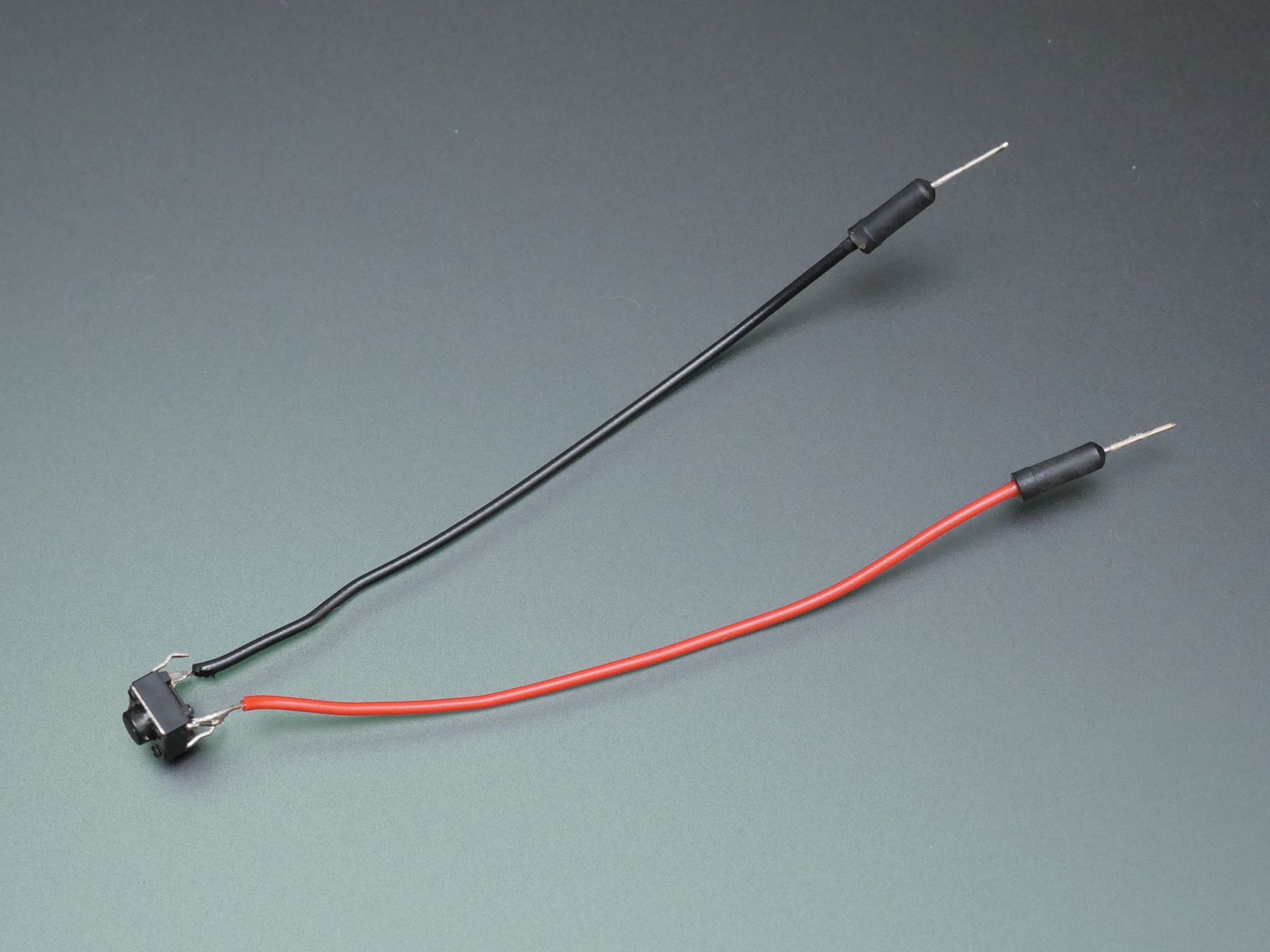

Practice your soldering skills again by attaching wires to two diagonal leads of a pushbutton. Tin the wires and the pushbutton leads, then reheat them to allow the solder to flow. Set this pushbutton aside for the final project.

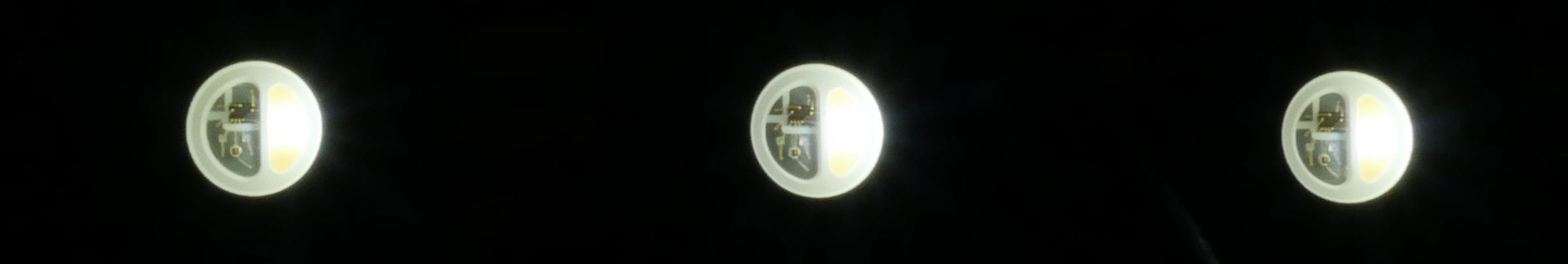

Take a close look at your pixel strip. Each pixel contains a very small RGB LED, which can theoretically create any color of light. However, generating pure white poses a challenge for RGB LEDs and often leaves users disappointed in the tinted or poorly mixed quality of light produced. For this reason, the RGBW strip includes a white LED inside its package as well.
Coding for these pixels will include four brightness values to describe a pixel color: red, green, blue, and white. This is similar to analogWrite(); in the RGB LED example from your first exercises: you provide a number from 0-255 to represent the brightness of the LED. The functions in the NeoPixel library take pixel numbers and these color values as arguments, then translate them into the commands to send along the LED strip.
