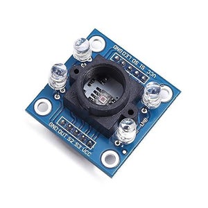

- Color Sensor https://www.amazon.com/Teyleten-Robot-TCS230-TCS3200-Recognition/dp/B08HH8QYF8/ref=sr_1_1_sspa?crid=Q9A5Y6N5UASJ&dib=eyJ2IjoiMSJ9.Rh-iSB4O8efW_XG-LqWoS7JqRyvm-lCQEnx0Tty4u3U-qWxccmUZs0nEX-puICsMMNmSJmNh-WEULsbXvYGBgH3Y2s87z4QfpABav1DTjikGUt4Wpp1DOEmf99sD5udLHp5soFLTNHo_8aroSlEP8cVN-GP8O1T9IF3sygKC-eBHO3m7yYZgI7-_SOa0BybOD8KHf_c7IjviINr_WHelwPb_SnrV9B4pW-ocmgqHPto.UJO7i4N7TQ44RUrs_IpL0jFPRUXNtGCm5azatJZzpLM&dib_tag=se&keywords=color+sensor+arduino&qid=1745278338&sprefix=color+sensor+arduino+%2Caps%2C152&sr=8-1-spons&sp_csd=d2lkZ2V0TmFtZT1zcF9hdGY&psc=1

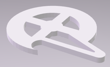

- 1 Base Plate
- Main plate that holds the sorted skittle tubes
- Filament: 27.36g
- Printing Time: 47 min
- 1 Rotating Disk
- Pushes the skittles from the color sensor to their respective tubes
- Filament: 21.74g
- Printing Time: 36 min

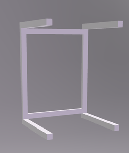

- 1 Frame
- Holds the cardboard platform of the Skittle Sorter
- Filament: 6.28g
- Printing Time: 54 min

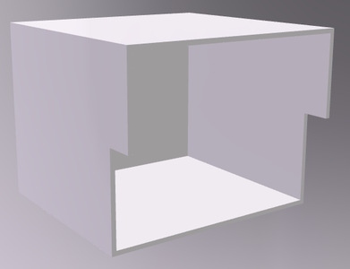

- 1 Cover
- Covers the color sensor from other interfering lights
- Filament: 156.03g
- Printing Time: 5 hr 36 min

- Wire the S0 pin from the color sensor to Pin 2 on the motherboard
- Wire the S1 pin from the color sensor to Pin 3 on the motherboard
- Wire the S2 pin form the color sensor to Pin 4 on the motherboard
- Wire the S3 pin form the color sensor to Pin 5 on the motherboard
- Wire the output pin from the color sensor to Pin 6 on the motherboard
- Wire the GND from the color sensor to any ground row hole on the breadboard
- Wire the VCC from the color sensor to any power rail hole on the breadboard

- Place the Frame on a flat surface with the four prongs facing upwards
- Center A onto the four prongs of the Frame and hot glue them together
- Slide the Arduino Uno under A and on top of the rectangular surface of the Frame

- Hot glue the Base Plate onto A, allowing the holes for the Vials to be extended off the platform whilst allowing the Servo to fit within the circular area of the Base Plate's design
- Center the Rotating Disk onto the Servo's rotor attachment, then hot glue together; make sure that the Rotating Disk and the Base Plate are aligned with one another, meaning they overlap one another almost exactly

- Create a hot glue wall in the shape of an L (look at images for reference); their purpose is to create a mini wall for the Cover to prop against when the Skittle Sorter is in action
Step 6: Procedures
These instructions are procedures to follow before running the code:
- When inserting Skittles into the Tube, make sure the Rotating Disk is under the Tube; Skittles will jam and/or spill out of the Tube if this is not checked
- When positioning the Cover onto the Skittle Sorter, make sure that the edge that hovers over the Rotating Disk
