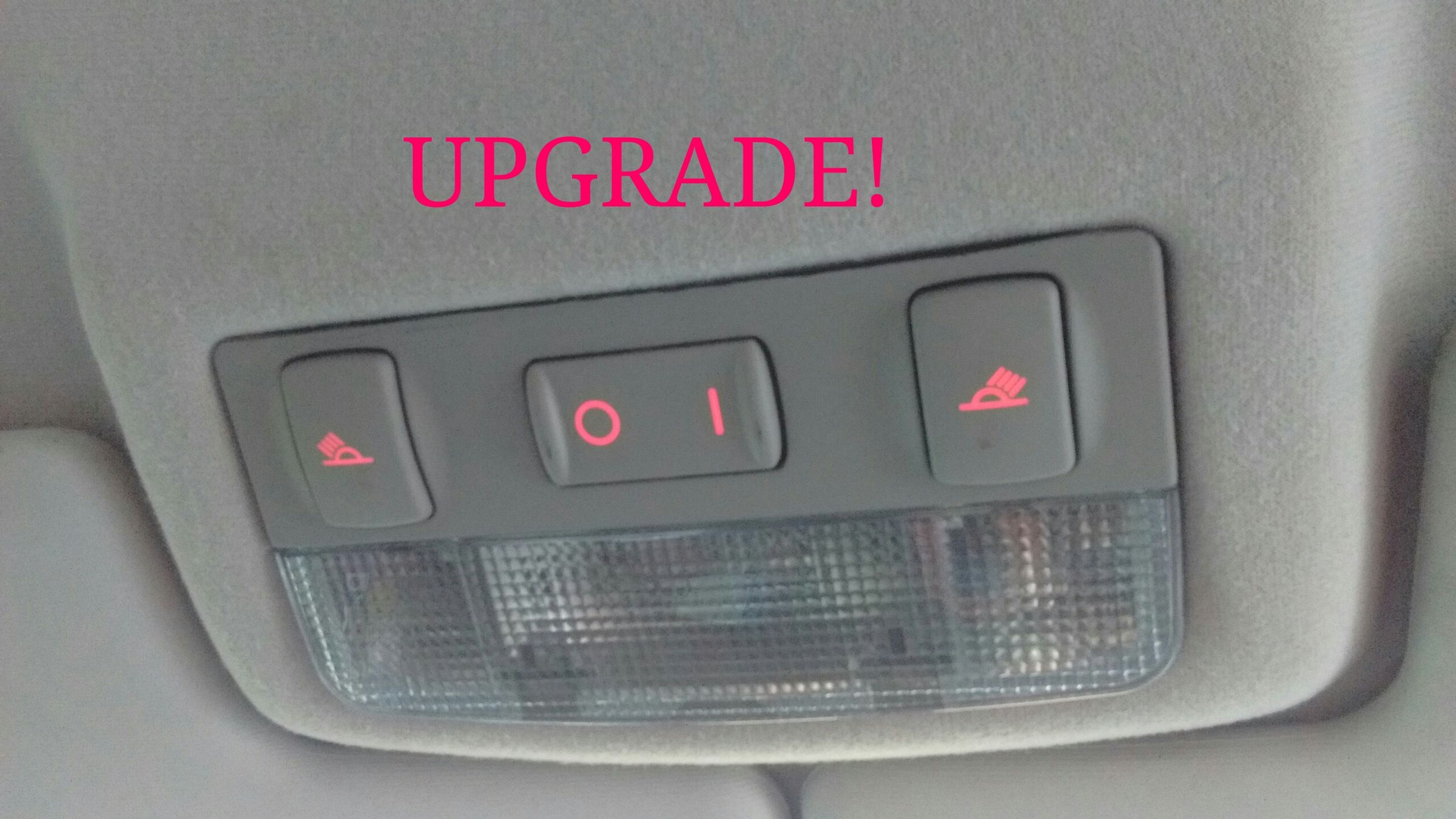

Step 10: Reassemble and Admire
Reassemble the instrument panel in reverse order of disassembly 'taking care to align the needles
I later added red mk4 VW Golf needles as seen in the illumination pictures
