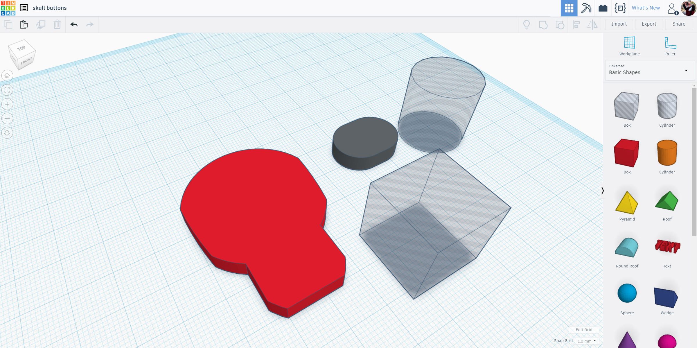

Start a new design and drop in a box and a cylinder onto the workplane. Select both primitives and grab the white handle on the top of the shapes to flatten them down. No need to be exact here since we'll be modifying the shapes again, just so long as they are the same height as each other. I think I used a height of about 7mm.
Select both shapes and use the align tool in the top right to align them along one axis.
We want the cylinder above the box, but don't want to mess up their alignment with each other. Simply hold the shift key while moving the shapes to keep them locked to an axis while they are being moved.
This is the basic shape of the skull.
