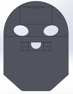

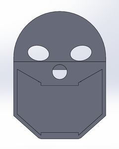

Step 1: Download Important Files
Download these files. The 3D models are so you can see it in 3D if you have Solidworks. The STL files you can use to print.
Step 2: Slice Files for Your Printer
Go to your slicing software on your computer, for example, Cura Ultimaker is what I used, scale it 10x to convert to cm and slice. Then get the file on the SD card of your printer.
Step 3: Print the Speaker Shell
Put your printer's SD card back into it and print the top and bottom separately. This should take around 30 hours because you need to print them separately.

Step 5: Put the Circuits in the Shells and Put the Shells Together
Glue the curcuits and speakers into the shells and put the shells together, finally plug it in and it'll work
