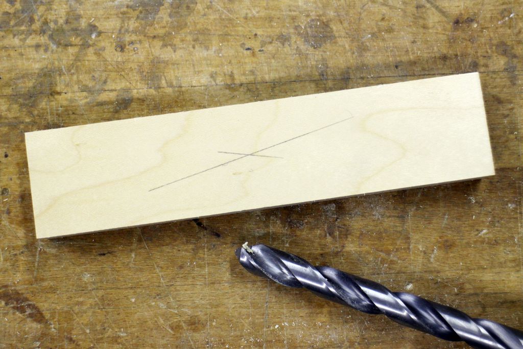

Step 4: Wood Base
To hold the bendy arm and provide a spot for a pillow I made a sturdy wood base from plywood scraps. The bulbed end of the bendy arm will be trapped inside the wood securing it in place.
I cut two sections of 6" x 12" from ½" plywood. Then cut a 1½" x 12" strip which would be the shoulder of the wood base that would hold the arm.
The center of the thin strip was found by drawing a diagonal line from the corner to its opposing side, where they intersect is the middle.
A ½" drill bit was used to drill an opening through this spot. This is where the bendy arm will extend from.
To capture the bulbous end of the bendy arm a 1" opening was drilled into one piece of the plywood for the base. This opening will line up with the ½" opening on the thin strip when the wood is laminated together.
I used a router to round over the edges of the shoulder piece and make it nicer to the touch.
