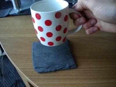

Introduction: Slate Coasters
This is a super cheap, super easy project that results in a super cool product :)

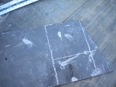

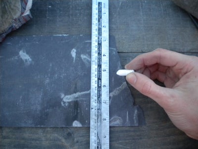

Step 1: Mark Out Slate
Use a ruler and a stick of chalk to mark your coaster

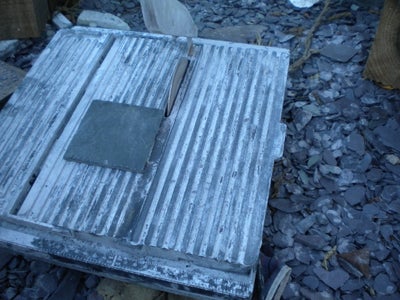

Step 2: Cut Slate
There are three ways of cutting the coaster, the most difficult is the 'old school' but it requires no power tools and if you get it right, it gives the nicest effect on the edges of the slate

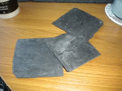

Old School Method
- Get a machete or thin strip of steel (2-3mm thick)
- Place the tile on a flat surface with a straight edge
- Smash the hell out of it :) (see video)

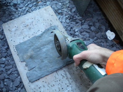

Quicker Method
- Use a diamond blade in an angle grinder
- Cut tile
Neatest Method
- Get a wet blade tile cutter
- Cut tile

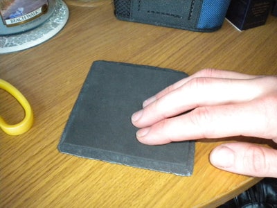

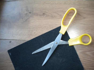

Step 3: Cut Foam to Size
Use scissors to cut a square of foam just smaller than the slate.

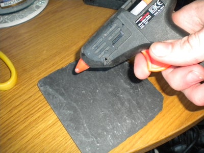

Step 4: Glueing the Foam

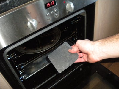

- Pre heat the slate in the oven, just warm it to 400C. If you don't the hot melt glue quickly solidifies against the cold slate
- Remove from oven and neatly create a square of glue on the slate
- Turn the coaster the right way up and squish the foam onto the slate and glue.
