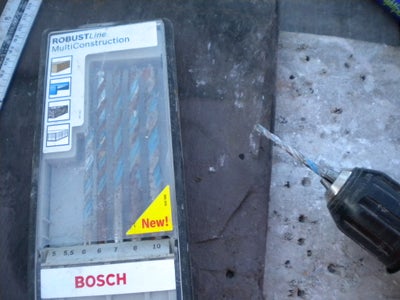

Drill + masonry or tile drill bit + Screwdriver bit

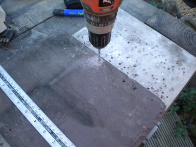

Step 1: Drilling Tiles

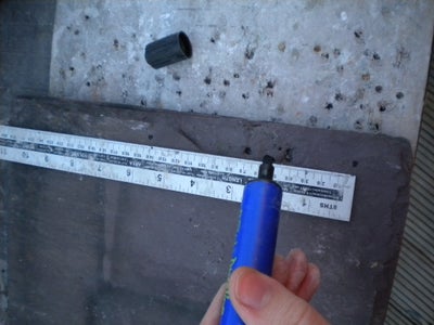

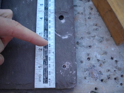

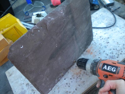

- Stack four tiles on top of each other, ensuring the nail holes and edges are aligned
- Measure and mark three holes for the screws (the nail holes count as one hole)
- Drill through all the tiles at once, be careful not move the tiles whist drilling. If they do move realign them immediately

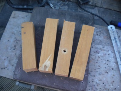

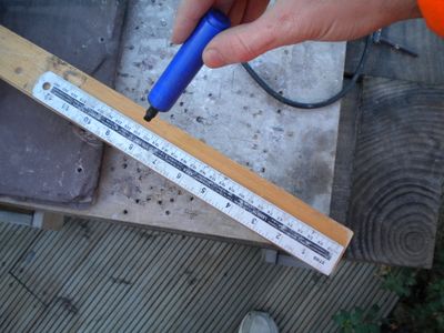

Step 2: Cutting the Wood Corners

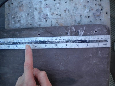

- Measure the distance between the bottom of the tile and the top hole, now add 20mm
- Cut four wooded batons to the measurement above
Step 3: Cutting the Wood Corners
- Measure from the bottom of the tile to in between the first and second holes (see the photo for clarity)
- Mark this onto each of the four batons and cut

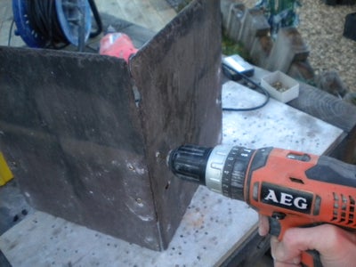

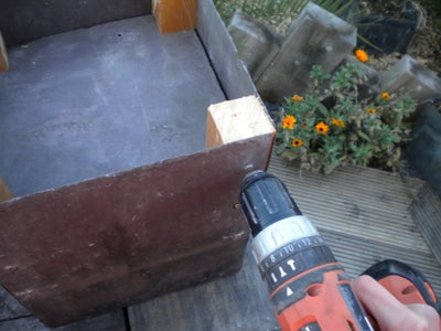

Step 4: Assemble
- I use Torx screws just because i think they look cool, any wood screw is fine though :)
- Ensure the wood is aligned with the edge of the tile before screwing in place

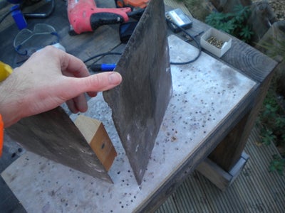

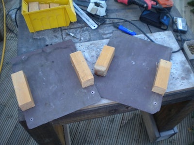

- Attach two batons to one tile covering the top and middle holes, this leaves the bottom home exposed
- Repeat on another tile
Step 5: Assemble

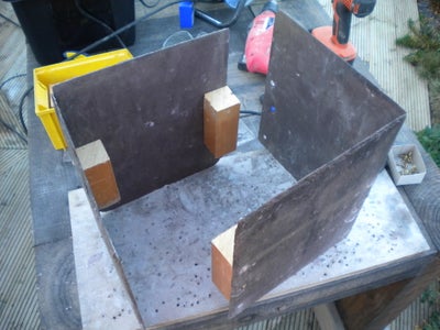

- Put the assembled tile on a flat surface
- Take a unassembled tile and align it to the edge of an assembled one
- Screw in place
- Repeat so you have two 'L' shapes

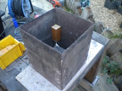

Step 6: Assemble
- Bring the two 'L' shapes together and screw together

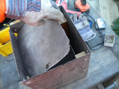

Step 7: Adding the Base
- Turn the pot upside down and add a slate to the inside
- You might have to cut the slate to size, there are three ways to do this, none are suitable for kids to do so adults only!
Old School Method
- Get a machete or thin strip of steel (2-3mm thick)
- Place the tile on a flat surface with a straight edge
- Smash the hell out of it :) (see video)
Quicker Method
- Use a diamond blade in an angle grinder
- Cut tile
Neatest Method
- Get a wet blade tile cutter
- Cut tile
Step 8: Fixing the Base
- Bolt the small pieces of wood in place
- Turn over and admire your new pot :)

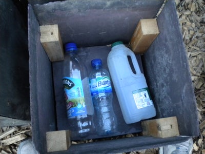

If you have made a large pot it would take a load of soil to fill and be soooooo heavy you would need a JCB to move it
Solution
Solution
- Use old water / milk / fizzy drink bottles and neatly stack in base. This is good for a number of reasons it resuses a waste product, makes the pot significantly lighter, and increases drainage
- Fill the middle with garden shreddings / grass cuttings / plant trimmings. This saves much money on compost :)
- Add compost to the top layer.
