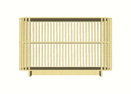

This slatted console table take inspiration from our 100+ year old house and from the "Vedima Console" by Lulu and Georgia.
Materials
  • White Oak
  • 2" screws
  • Finish - I used water based polyurethane
Tools
  • Table Saw
  • Jig Saw
  • Biscuit Joiner
  • Router w/ 1/4" round over
  • Drill - with a few different sized bits
  • Drill Press w/ Plug hole bit
  • Orbital Sander
Step 1: The Slats
  • Cut the slats to the desired width. Mine are 1" wide
  • Use a router table to make a round over edge to the slats. I used 1/4"
  • Sand smooth
Step 2: The Shelves - Assembly
  • The white oak that I purchased was already planed and had straight edges.
  • I lined up the boards to find the best matches for each.
  • I used a biscuit joiner to keep the shelves plane.
  • I made (3) 14" x 64" shelves and sanded them to remove marks and glue.
Step 3: The Shelves - Round Ends
  • Mark out a 7" radius circle at the ends of the boards
  • Cut just outside of the line with the jog saw
  • I made a circle cutting template with spare plywood to attach to the router. Using a trim bit, I smoothed out the edges to meet the line.
Step 4: The Shelves - Cut Notches
  • I made a template out of 1/4" plywood with the size and spacing of my slats.
  • Transfer the pattern onto the boards
  • Drill corners to fit the round over edges of your slats
  • Cut the straight edges with the jig saw
  • I used an offcut of the slats to ensure a good fit.
Step 5: Console - Assembly
  • I made a spacer jig out of mdf and 2x4s to establish the heights of my shelves.
  • Center the shelves and begin laying the slats into the notches
  • I left the slats long on one end. They will be cut and sanded flush at the end.
Step 6: Console - Attachments
  • Drill pilot holes for screw attachments
  • Drill an oversized hole to recess the screw about 1/2 way through the slat
  • Install screw
  • Cut plugs the same size as the oversized hole
  • Insert plugs into the screw holes and sand flush
Step 7: Console - Base
  • Leave 4 slats that are directly across from one another for the legs
  • Stop the round over where it leaves enough room for the space beneath the bottom shelf to attach flush to another piece.
  • Install these longer pieces in the designated notches
  • Install a piece of wood to connect the front and back legs
  • Install another piece of wood horizontally to connect the left and right bases
Step 8: Finish Console
  • Sand smooth to a fine grit
  • Apply finish
  • Style and enjoy!
