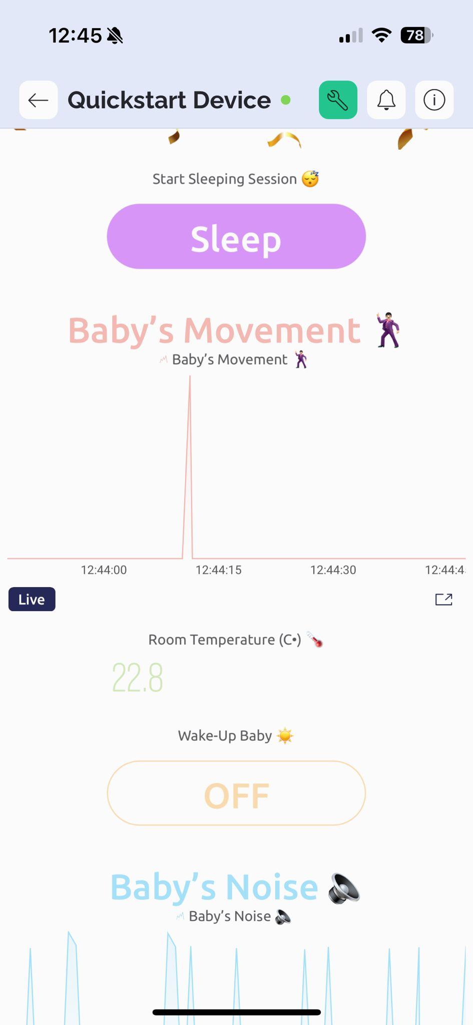

Define datastreams as follows:
  • V0 - Virtual pin - for "Start sleeping session" button
  • V1 - Virtual pin - for Baby's movement detection super-chart.
  • V2 - Virtual pin - for Roon temperature value display.
  • V3 - Virtual pin - for the "Wake up baby" button.
  • V4 - Virtual pin - for Baby's noise detection super-chart.
After all data streams are defined, start adding the following components to your dashboard:
  • Configure two buttons—one for "Start sleeping session" and one for "Wake up baby" (initiating an alarm). Both buttons need "switch" buttons; see the attached screenshot.
  • Configure two super charts-one for "Baby's movement detection" and one for "Baby's noise detection". Both charts are line-charts.
  • Configure one value display component- for presenting the room's temperature.
Make sure to connect the right datastreams to the right components.
Step 3: Edit Your Dashboard
We edited the dashboard with relevant emojis and selected pastel colors, which should suit Baby's color palette.
Look at the dashboard's design in the attached screenshot, and play&plug with it.
Dashboard Components:
  • "Start sleeping session" button - our code requires an indicator that a sleeping session has started. We will use a simple "switch" button for the user to configure it. This is a boolean button:
  • "Awake" - represents OFF.
  • "Sleep" - represents ON.
  • "Baby's Movement" detection super-chart - whenever the baby's moving during the night, it will affect the mattress which will impact the baby's movement detection. The chart will collect the data and you can track movement in real-time.
  • "Roon Temperature" value display- We will present the room's current temperature. The values are double numbers (2 points after the dot) and represent the room Celsius degrees.
  • "Wake up baby" button—a simple "switch" button for playing a short part of the "Fur Elise" melody. We intend the button to be used as a nice alarm for the baby (this is why the button name is "wake up baby"), but users can also use it to play a nice lullaby. When the button is pressed, the melody starts.
  • "Baby's Noise" detection super-chart- Track and collect data about the baby's crying during the night. The data will be collected via the chart.
