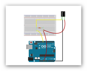

Step 1:
The circuit is very easy.The real work is programming windows to apply the push virtually on buttons based in which button the Arduino sends over Serial port after being recognized
