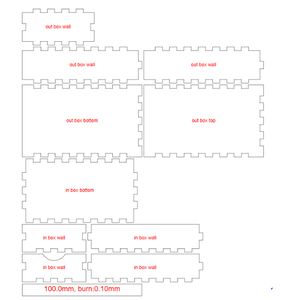

The first step was going to https://boxes.hackerspace-bamberg.de/SlidingDrawer?language=en and grabbing a picture of all the parts.
Step 2: Creating Laser Engravings
The second step was to bring that PNG into this software to finish creating the box: https://re3.netlify.app/designer?model=gen8titan.
Step 3: Final Touches
The criteria were to avoid waste, squeeze it into a 12 by 12, and increase its size. After Creating the perfect dimensions to fit the 12 by 12, I downloaded the file and laser cut the outlines at 90% speed and 60% power. I used 80% speed and 50% speed for the Rasterized pictures for design. High speed, lower power is really good for laser cutting images.
