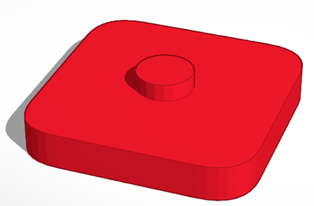

Step 1: Creating the 1x1 Blocks
Go to Tinkercad and create a project.
Click the drop down box in the shapes library and select shape generators.
Click and drag the softbox shape to the workplane.
Click the softbox and set the options to the following:
  • X Dim: 19.5
  • Y Dim: 19.5
  • Z Dim: 6
  • Wall: 100
  • Outer Radius: 5
Click the drop down box in the shapes library and select basic shapes.
Drag the cylinder into the center of the softbox.
Set the dimensions of the cylinder to the following
  • Width: 8 mm
  • Length: 8 mm
  • Height: 8 mm
Set the color of both shapes to white.
Repeat these steps in another project and set the color to red.
Make sure everything is centered by setting the positions of all to the middle.

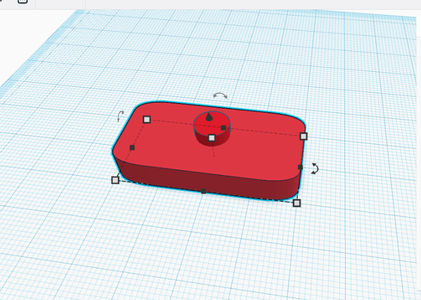

Step 2: Creating the 2x1 Block
Create a new project in Tinkercad.
  • X Dim: 39.5
  • Y Dim: 19.5
  • Z Dim: 6
  • Wall: 100
  • Outer Radius: 5
  • Width: 8 mm
  • Length: 8 mm
  • Height: 8 mm
Set the colors to the same shade of red that was previously used.
Make sure everything is centered by setting the positions of all blocks to the middle.

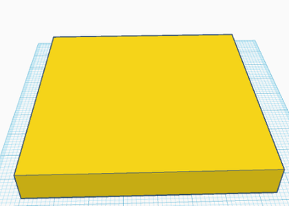

Step 4: Creating the Board Frame
Click and drag a cube shape to the workplane.
Click the cube and set the options to the following:
  • Radius: 0
  • Steps: 10
  • Width: 110
  • Length: 110
  • Height: 10
Make sure the cube is at the center of the workplane.

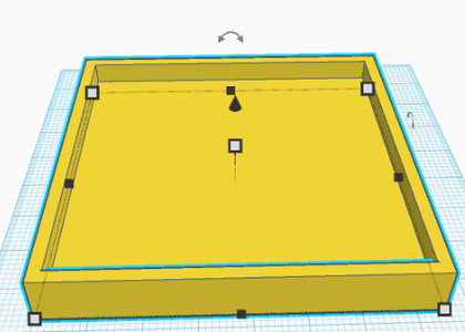

Step 5: Making the Board Hollow
Duplicate the cube used for the board frame and set the options to the following:
  • Hole (Make sure the blocks is a hole and not solid. It should make the block semi-transparent)
  • Radius: 0
  • Steps: 10
  • Width: 100
  • Length:100
  • Height: 10
Elevate this shape 5 millimeters above the workplane.
Make sure everything is at the center of the workplane.
Highlight both shapes and click the group button or press CTRL + G
Set the color of the board to yellow.
