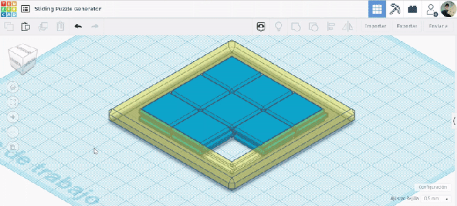

Step 9: Aligning Both Models
It is of crucial importance to emphasize that these models MUST NOT ALIGN CONCENTRICALLY. In order to function correctly, they must be 0.5 mm apart from each other on both sides (their centers must not coincide).
I recommend changing the view type to "orthogonal view" and the grid spacing by 0.5 mm; this way you can better control the movement of the models, try to select one of the two parts (change its color to "transparent") and with the help of the keyboard arrows move the part slightly in two directions.
If you switch the view between the side and top view, you should be able to see a slight gap separating the pieces in all views.
