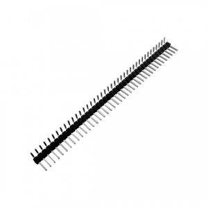

1x 40 Pins Header Male - 90 Graden - Type B
