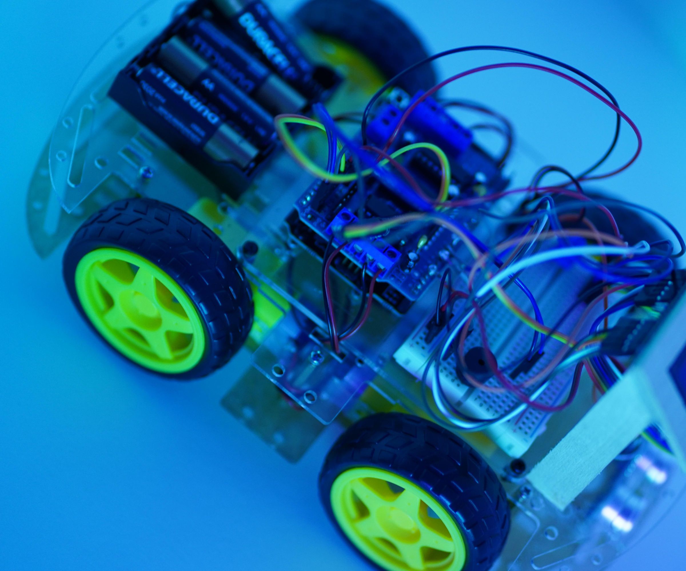

Slimey is a mobile, 4d printing robot. The goal of this robot is to elevate the advancements of 4d printing with a mobile robotics platform in order to expand upon the possibilities in computational design and digital fabrication. Projects that use similar 4d printing techniques are currently limited to the size of the printer and the build plate/ area which is predetermined. With Slimy, was constructed as a small demonstrator for this system, the possibility in scales are limitless.

Step 1: Assemble 3d Printed Files and Hardware
Check exploded axon and render for assembly.

Step 2: Step 2: Wire Up the Circuit and Upload Code
This Code is not correct for now. It is currently working with a different motor shield using L293d motor driver chips using AFMotor Library. New code concerning the updated CNC shield with A4988 Chips will be uploaded shortly.

Step 3: Step 3: Assembly Printing Surface
Stretch out the fabric onto a larger, rigid base and use the binder clips to hold down the edges. Draw one continuous line with a contrasting color onto the fabric.
Step 4: Step 4: Plug Slimy Into the 12v Power Supply and the Glue Gun Into Another Wall Power Source
Place Slimy in the direction of the line so that it will find it. Once it finds the line, it will begin to extrude the glue onto the surface. Once Slimy has completed the path, turn it off and cut out the finished piece from the base with scissors.
