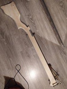

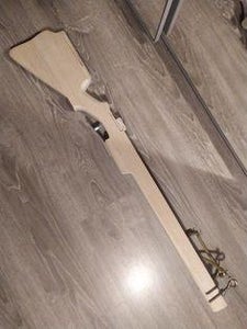

You can skip this passage if you have a big enough slab for your tastes anyway I highly suggest that you use at least a 2by2 glued on a 2by4 like I showed you in the pictures. This are the pictures of the gluing process as i had to do it in steps because i don't have enough "clamping power".
