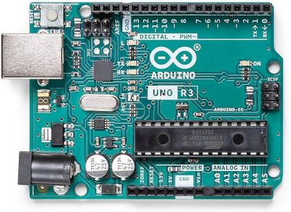

  1. Ardunio Uno with cord

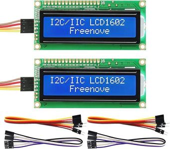

  6. I2C LCD 1602 Module

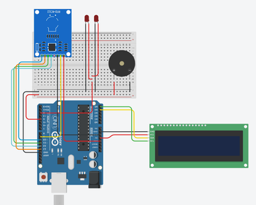

Step 2: Create the Circuit Board
Secondly, we want to set up our Ardunio Uno board. We connect our wires as seen in the picture above. We also connect our buzzer and our LCD screen and two red LEDs as indicated.

  1. For your first cutout, you will want to measure your LCD screen and make a cut out on your front piece. Make sure your cutout is not too big or else your LCD screen won't fit nice and snug. Example picture 3 is what this cutout should look like.
  2. Your second cutout on your front piece should resemble a square this will be in the shape of your RC522. This cutout is so your RC522 will be able to be scanned easier. Example picture 3 is what this cutout should look like.
