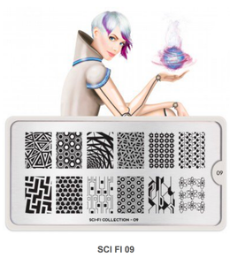

Mervin stamp plate, Mervin Gray Polish (also known as MoYou Cloudy Day), MoYou Crystal Clear Stamper, MoYou Sci-Fi Plate 09, plus Mervin Pins and other #SlothSwag!
