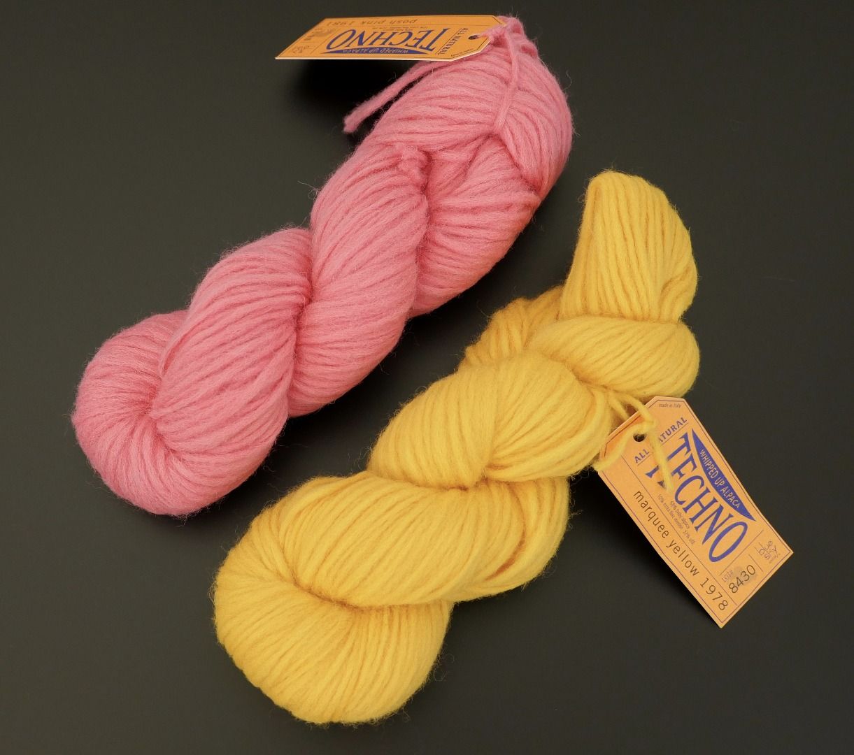

Grab some worsted weight yarn and your size 8 circular needle. Knit a swatch and check your gauge: recommended for this project is 4.5 sts/6 rows per inch or 17 sts/23 rows = 10cm in st st.

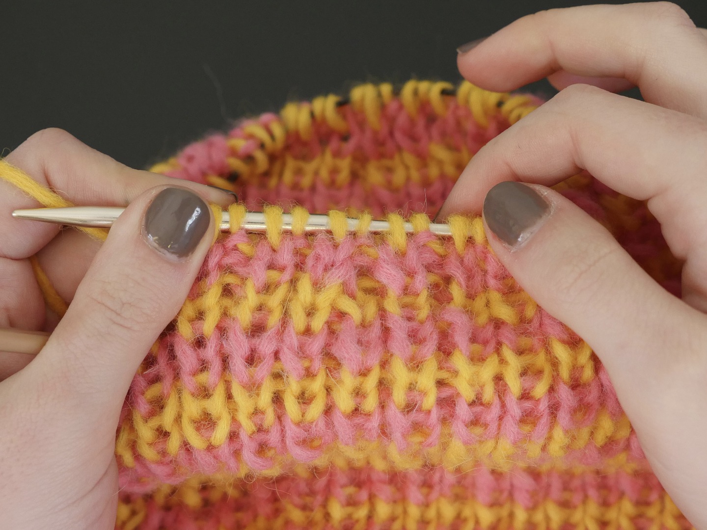

Step 2: Stripes!
To knit in stripes with two colors, make two rows in your first color, then place a stitch marker and start working in your second color, without cutting the first.
After another two rows you can swap back to the first color by just picking up the working yarn where you left off.
Since the stripes are only two rows tall, the alternate color working yarn can be picked up without cutting. The yarn will make the short span across the short stripe. For larger stripes, you will need to cut long tails and add the new color as if starting a new skein, then weave in all the yarn ends later on.
Step 3: Knit Like the Wind
Continue in K1, P1 rib until you have about 14 stripes of each color, or until the hat measures approx 10 inches/25 cm tall. In the next lesson, you'll learn how to create the dome shape at the top of the hat.

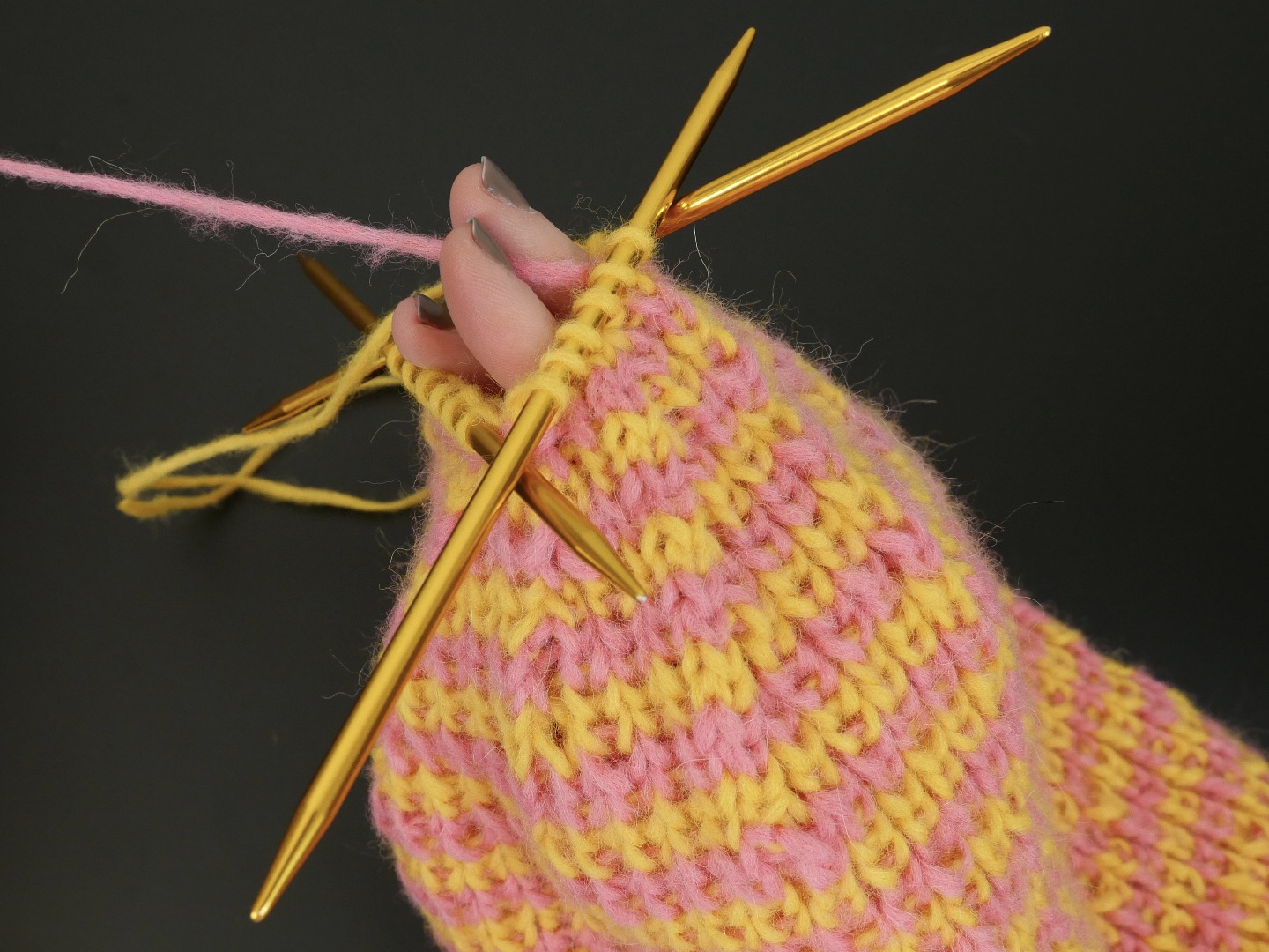

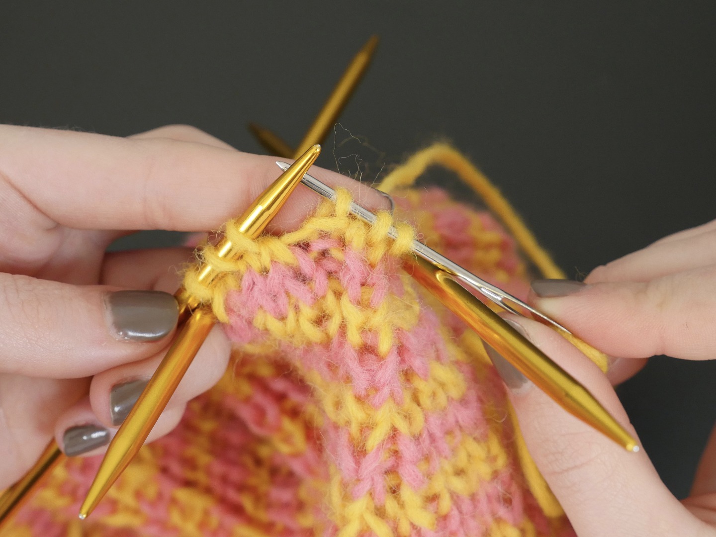

Step 5: Switch to DPNs
To knit small round things, like the very top of your new hat, double pointed needles (DPNs) are necessary, and not as hard to use as they may seem!
At the start of a new row, pick up a DPN in your right hand and start knitting in the same K1, P1 rib onto it. Knit one third of the stitches (does not have to be exact) onto this first DPN, then scrunch the stitches to the center of the needle and pick up another one. Knit another third of your stitches onto the next DPN, and so on for the third DPN.
To knit the next row, position the first DPN on top of its neighbors, and pick up your fourth DPN. Knit all the stitches from your first DPN onto the new one (remember to count stitches and perform decreases), then your newly emptied needle will become the right needle for the following set of stitches. You are still knitting in the round, but now the round can shrink smaller as the work does. Continue alternating decrease rows until 16 stitches remain.

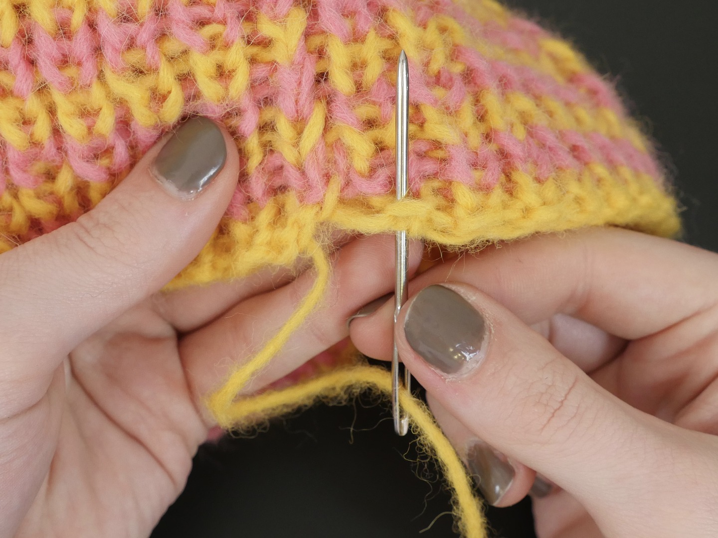

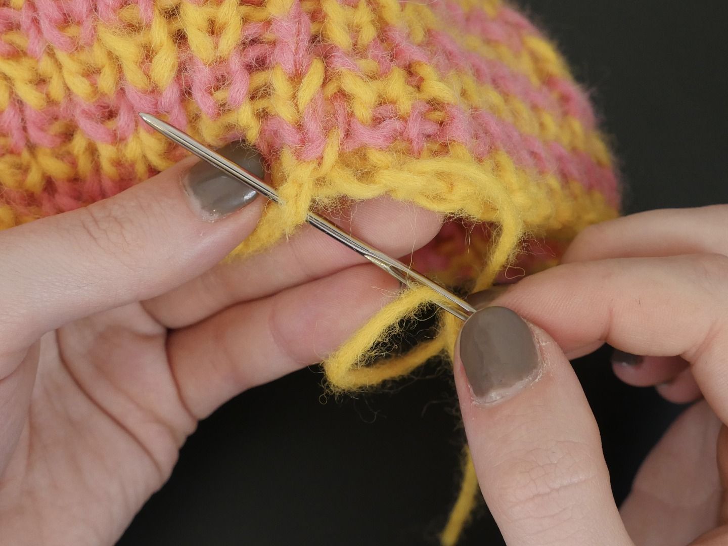

Step 6: Finishing Touches!
Cut both colors with a 12 inch tail, and thread the working color onto a yarn needle. Pull the nonworking color tail to the inside of the hat.
Slip all stitches onto the yarn needle and pull tight to cinch the top of your hat closed.
Thread the needle through the top stitches one more time before weaving in the end.
At the brim of your hat, you can smooth the seam a bit by weaving in the yarn tail across it. Weave in any other yarn ends on the inside of the hat.
