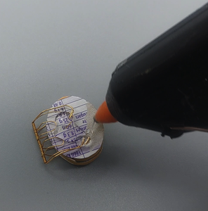

Step 4: Hot Glue Magic
Now get a glue gun out and place a good amount of glue on the wire. Don't touch the wire because it gets hot! (I learned from experience)
Press the glue down with baking paper (or silicone) and something flat. This ensures that the locket doesn't get too bulky.
Repeat the process on the other side and test the hinge. Then reinforce the wires that come from the hinge with hot glue.
