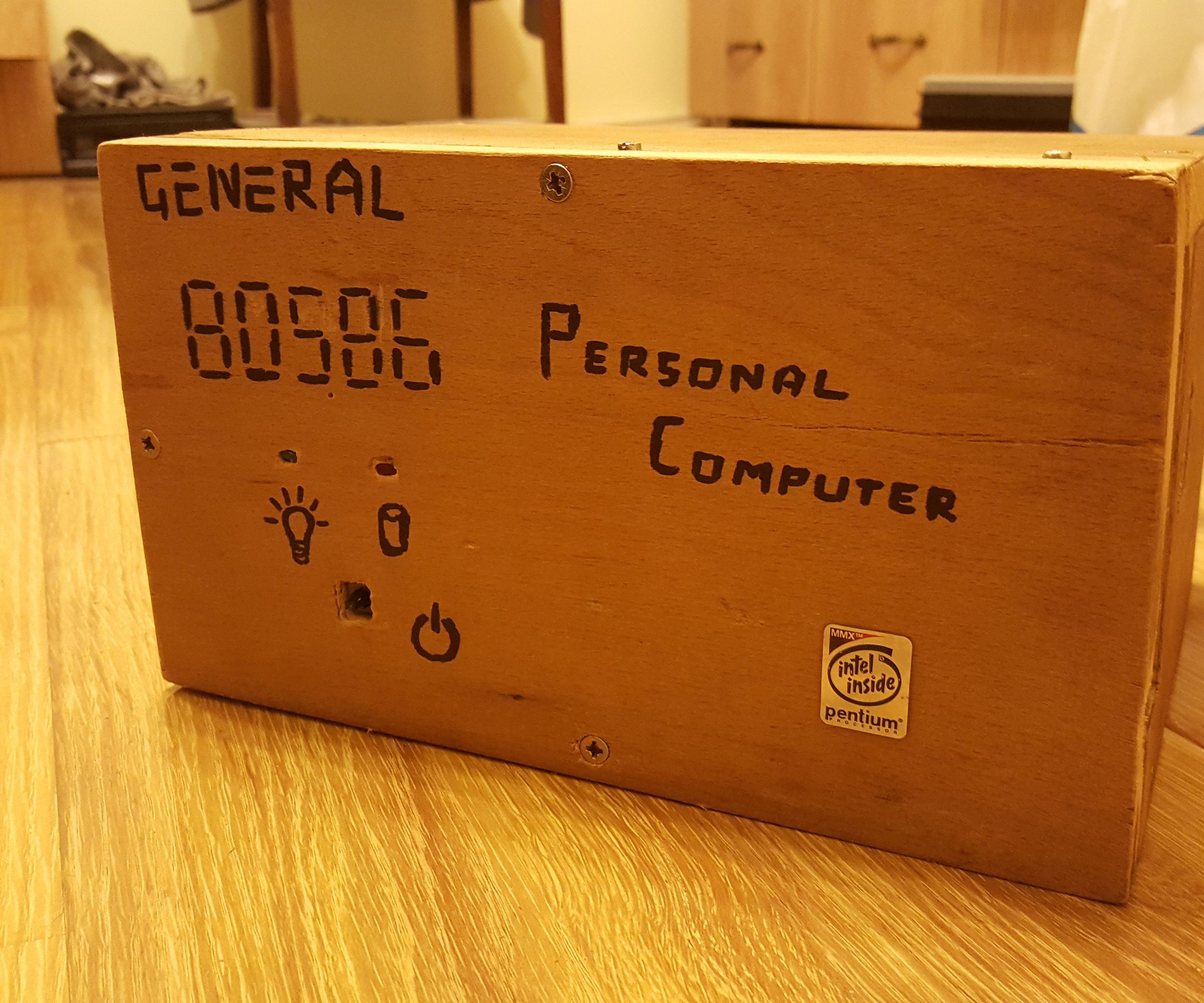

Introduction: Small Computer Case
In this tutorial i will show you how i built my own small computer case out of basic materials, using basic tools.
This case is made out of transparent acrylic glass surrounded by an aluminium frame.

25/09/2016: so far, the computer does not look pretty and is not fully finished yet, because i don't really have time to finish it (school...), so an update will be coming in the future.
UPDATE 26/07/2018: This computer has served my grandparents for almost two years in this state (behind the TV obviously) until recently, as they switched to a newer computer. Surprisingly, it still works, but I will have to take it apart, because I have no use / any storage place for it. Fare well, old computer!
