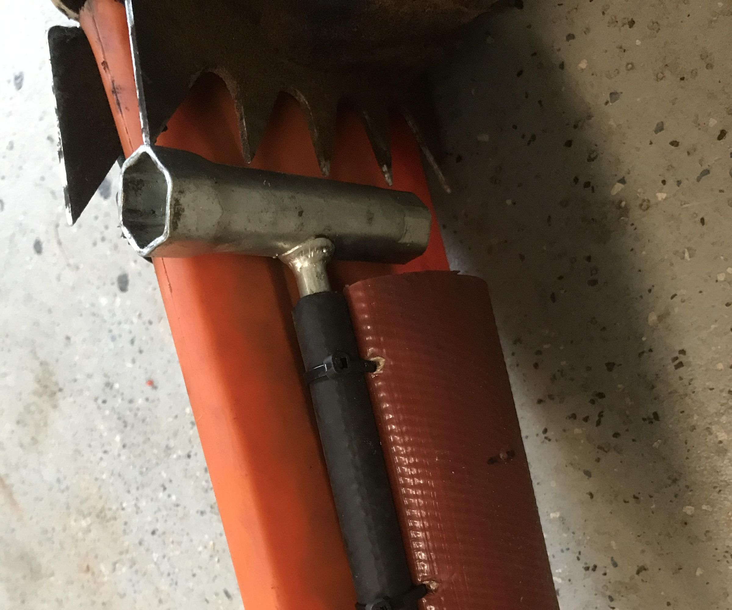

I couldn’t find a small spark plug tester so modified a standard automotive plug tester. Took less than 1/2hr to figure it out and works spot on. I left one side unmodified so I can test both sizes. Works a treat. Alot quicker than using a multi meter and only taking a matter of seconds. I fitted an internal 9v battery instead of using the power supply. Not sure how many tests I’ll get out of one battery. If it doesn’t last, there is enough room to fit a second battery. Be able to run in series and use a buck converter if needed. For now, it works well.
