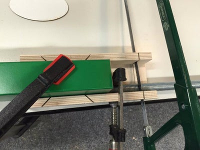

The rack will use 4 pieces of threaded rod, one in each corner. I just split the two 1m pieces I bought in half, so I had four 50cm pieces. That came out to 38cm distance between the two boards of the rack.
Try to get the cut as straight as possible. I bought a saw guide at the hardware store, and used one of the LACK legs (we'll not use them anyways) and some clamps to secure the rod in place, before going at it with a metall saw. Beware, this will take some time, and you might ruin your saw blade. So make sure you got some spare blades, just in case.
After sawing the rods, I'd recommend filing the ends a bit to get rid of any shard edges that might cut you later.

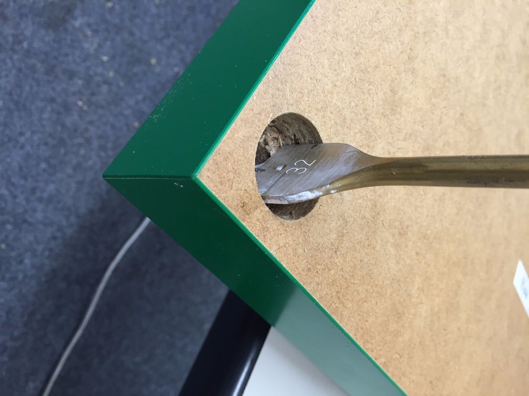

Now, get the 32mm flat wood bit, and mark off the thickness of the nuts you bought on the bit. Slowly start drilling into the corner, from the bottom of the board. If you are using a hand drill, try to be as straight as possible. Ideally, you'd be using a drill press for this. Make the hole only a little bit deeper that the height of the M18 nut.
Once you finished the bottom hole for the nut, flip the board around, and drill the 18mm (or 20mm) hole from the top, using the predrilled hole you made earlier. Be slow and gentle, as to not scratch or break the nice surface of the board.
Clean the hole from both sides with a small knife or a piece of sanding paper, and repeat for the other 3 corners.

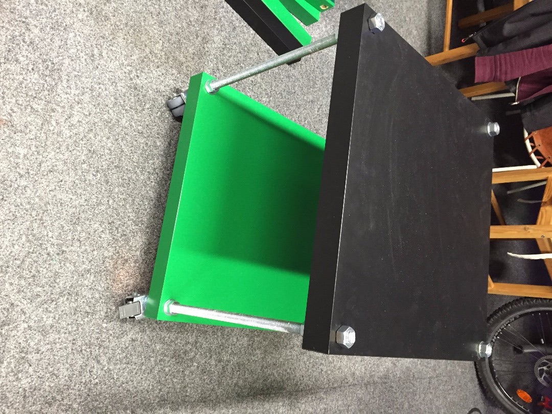

Before putting on the top board, put one nut and one washer on each rod from the top, and screw them in for about 8cm, for the top board to rest on.
Now, place the top board on the rods and push it down until it rests on the nuts and washers we put in just before. This may require a bit of force or wiggling the board around. Try to make small movements on the different rods, compared to big ones on a single rod, which might make the other rods tilt in their holes and block any further movement.
Once the board lies on the nuts and washers, take the remaining washers and nuts, and place them on top of the top board n the rods, to secure the board in place.
You may also now tighten the nuts on the bottom plate.
