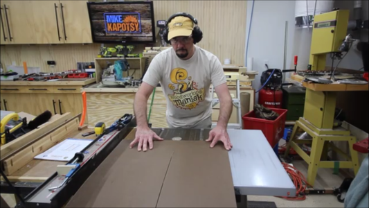

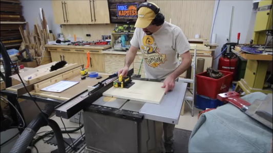

Once I have the overall design laid out, now I turn to cutting the plywood panels for the sides and top and bottom of the cabinet. It is important to leave them oversized at this point because design changes may call for adjustments to be made.

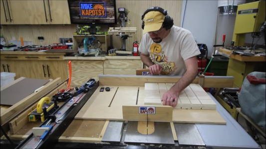

I cut the panels down on the table saw. If you do not have a table saw, then you could use either a circular or jig saw with an edge guide to ensure straight cuts. Then I turn to cutting the dados. Dados are slots cut partially into the plywood. I use a dado stack on the table saw (blades stacked together on the arbor to cut a wider slot). If you don't have a dado stack, you can do the same thing by adjusting the fence in small increments to achieve the width of slot you desire. I cut a slot just slightly larger than the thickness of the divider material which was 3/16" thick. Cut 2 or 3 slots then rotate the panel and cut the remaining ones from the other end. This prevents the panel from getting away from you and is a safer method.

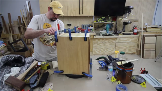

Glue the strips on the edge of the plywood using a sufficient amount of glue and spreading it out. I like to use blue painter's tape to hold the strip in place along with a couple of edge 3 way clamps.

Once the hardwood edging is glued in place, the panels can now be trimmed down to final height. I do this on the table saw using a cross-cut sled. It is a safer method and provides a nice clean 90 degree cut. Blue painter's tape is recommended in this step also to prevent tearout on the veneer.
If you don't have a cross-cut sled, consider building one. However you can also use a miter gauge with an auxiliary fence attached. I suggest cutting through the hardwood edging first to ensure a clean cut.

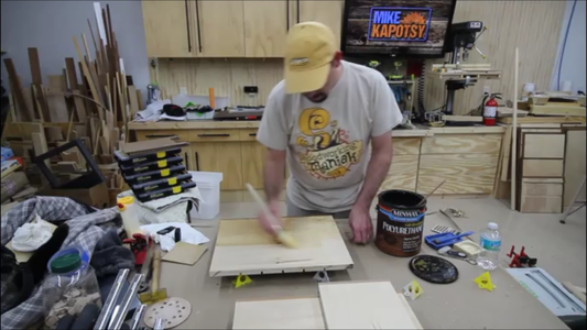

Step 9: Applying the Finish
For the last couple of build projects, I've been pre-finishing the pieces prior to assembly. For a project such as this, pre-finishing makes the assembly go easier and no worries about finish pooling up in the corners. I utilized a Minwax product on this cabinet, it's an oil-modified water-based polyurethane. It goes on easy and the clean-up is simple: warm soapy water. I used an artificial bristle brush to apply the finish because a foam brush can have a tendency to snag the fine fibers of the plywood. I applied two coats on this shop-furniture project sanding lightly with 400 grit sandpaper by hand between coats.

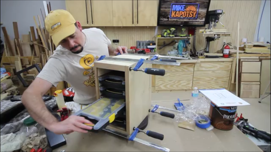

Step 10: Performing the Final Assembly
Once all the pieces are dry, the final assembly process can be completed. Having glue, dominos, a damp cloth, dead-blow mallet and glue spreader handy is important. Apply a liberal amount of glue in the mortises or holes depending on type of joinery and along the glue lines. Insert tenons or dowels and begin to assemble. Move quickly and use a dead-blow mallet to assist. This will prevent marring the piece during this process. Clamping is important as well to ensure tight glue joints.

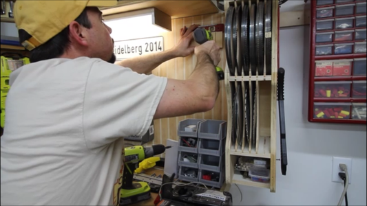

Step 11: Installing the Cabinet
The final step is to install the finished cabinet. A French cleat is ideal for this type of project. This is simply installing a piece of plywood with a 45 degree bevel on the top aiming point away from the wall. Install a similar mating cleat inside the back of the cabinet. I recessed the cleat on the cabinet so it would mount flush to the wall.
