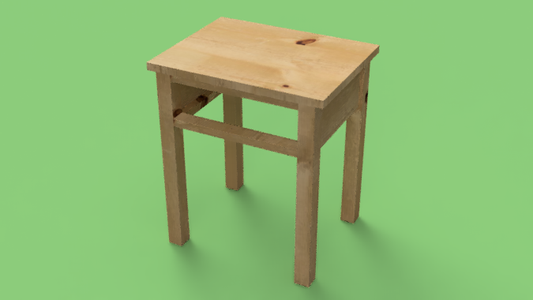

Introduction: Small Side Table
This small side table is designed to be a beginner project that can be managed by a high school student.
With minor changes to the shape or size of parts, this project can be easily personalized while still being successful.
based on a design from the book "Handmade Furniture: 21 Classic Woodworking Projects to Build for Your Home by RAFAEL NATHAN"

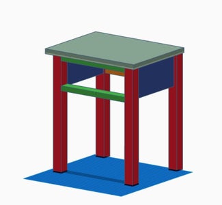

Cutting list
Table
- legs 40 x 40 x 500 x 4
- side rails 20 x 140 x 265 x 2
- back rail 20 x 140 x 330
- front rails 20 x 40 x 330 x 2
- table top material to make 450 x 365
- draw support 20 x 40 x 285 x 2
- draw guides 20 x 20 x 270 x 2
Drawer
- sides 20 x 90 x 270 x 2
- back & front 20 x 80 x 306 x 2
- dress front 20 x 366 x 120
- Base MDF 305 x 235
glue, brackets to attach top to frame, drawer handle

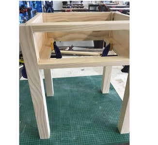

Step 3: Assembly
Assemble the two sides, glue, square, clamp, and leave to dry
Assemble the whole frame by gluing the front and back rails in place, glue, square, clamp, and leave to dry
Note: I know you will want to glue it all together all at once, avoid this action, you will need to concentrate on getting the frame square and neat. If you try and put it all together at once and become rushed for time, this ensures a ticket to wonky town. Take your time, and enjoy your work.
